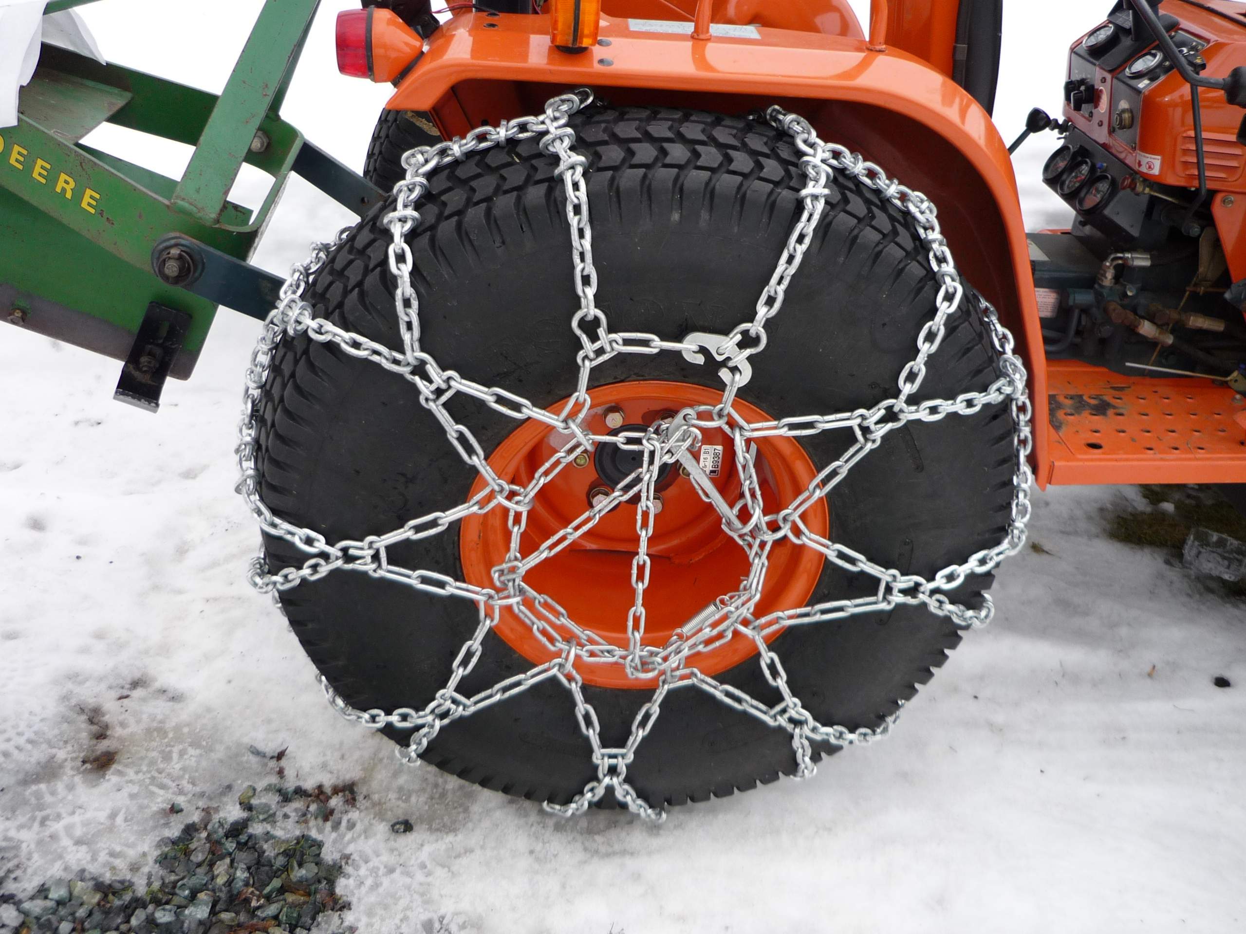

I just fitted a pair of euro style "net" chains to my tractor's turfs. In consultation with tirechain.com guys, I removed some of the side links with a bolt cutter (not hardened) but removing some of the cross links, which were hardened, required a small abrasive wheel cutter. The attaching links were malleable, so no problem. The Tirechain guys, and others with experience, told me that you want them tight, both for the tire's sake and for the long life of the chain. They work better, too. Some have recommend softening the tire pressure, installing the chains, and pumping the tires back up, but I have been discouraged from that. My style chains have no need for additional tensioners, and they quickly adjust.
I attached the foto so you can see what "net" chains look like. they are supposed to be very good for on road use. I like 'em.

Sorry varmint, but that looks like a mess. :) No offense, but I can't imagine that those chains are close to being the right size for your tires.
A lot of chain sets are sold that fall into the "few sizes fit all tires" category. Much less inventory doing it that way, but are supplied way oversize for some tires.
A key is the length of the cross chains. They should only reach across the surface of the tire and down the side as far as you want them to go. If they don't need to be shortened, then fit/cut the inside side-chain to the length that leaves a good circle (no dips). Then fit/cut the outside side-chain to the hand-tight length leaving two links free for mounting the chain next time. Should need no tighteners if the chains are fitted to the tires.
