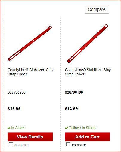

The pto shaft shouldn't be an issue. The stay straps are those something common or something we will need to fabricate ourselves. Also would I be better served using a 3 point tow system instead of the bar system and yes it has the holes going across like you said.

Use a 3 point stabilizer/stay strap set up on the 3 point draw bar currently using. It consists of an upper and lower half (2 bars per side) that fasten to the top link bracket of the tractor and over the lower pin on 3 point, then are bolted together. This will hold the 3pt arms in position for a stationary drawbar.
Photo snipped from TSC catalog:

Thank you I did see those at farm and home when I was buying the bar. Thanks again
