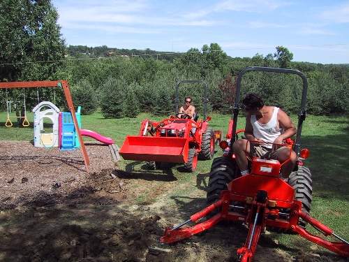

First I had to dig the hole (preferably somewhere near the existing water line/w3tcompact/icons/crazy.gif). The specs on the tank say that the top of it must be buried between 8 and 32 inches below the surface. The tank is 60 inches high, and it must sit on 6-12 inches of compacted pea gravel. That meant the minimum depth of the hole had to be 74 inches. I have a 4672 hoe, so I knew I would need to use my excavator - the Armstrong Universal Pick and Shovel/w3tcompact/icons/frown.gif Also, the ground slopes some, so we would need to be deeper on the high side by about 6 more inches. Thats a lot of digging in northeast clay/rock hardpan. We almost broke the Armstrong several times/w3tcompact/icons/tongue.gif, but found that lubrication and fuel replenishment on a frequent basis helped considerably - (bbq beef, gatorade and the occasional Molson)/w3tcompact/icons/cool.gif
With the side and end clearances added in, I calculated the hole to be around 19cu yds. The tank was 8 yards, and the gravel fill was 9. That amount of dirt needs to be removed as you dig, or you will shortly find yourself boxed in. My buddy brough his 'bota over (another 2710) and he moved the piles with his FEL as I created them with my hoe. Since I was at the limits of the hoe, HOW I dug the hole was also very important, otherwise I might end up with large chunks of dirt that I could not get at (no place to park the tractor). At one point someone commented on the two tractors and said, "Oh, you've got a $45000 hole here!" All of this digging took place on Saturday and Sunday morning.

My buddy Rich digging the big hole

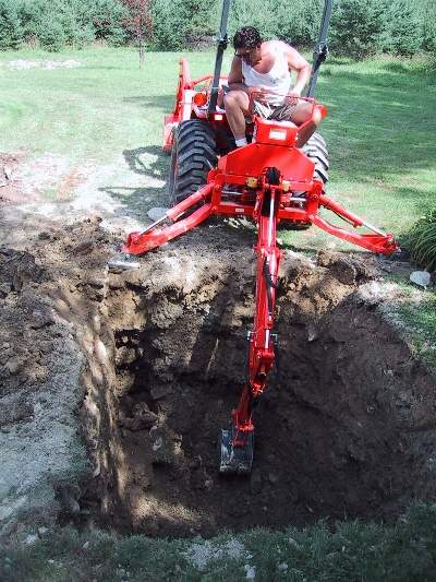

   / Fix a slow well cheaply (sorta) Part 1
A pair of 2710s - Way to go!

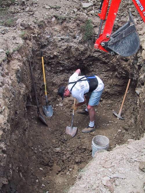

When the Kubota couldn't reach, it was time for the Armstrong combination excavator. First we used the Armstrong pick.

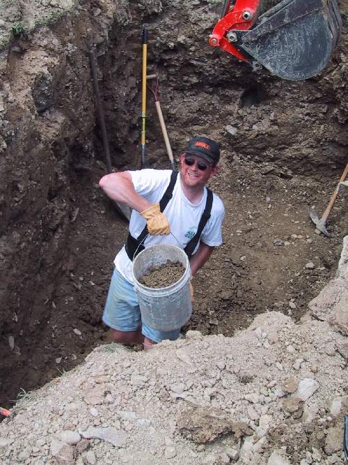

Then we used the Armstrong Shovel.
And finally the Armstrong bucket. It seems smaller than the Kubota hoe bucket, too/w3tcompact/icons/wink.gif
