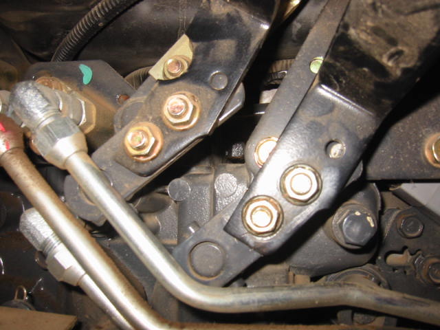

Hope this isn't too stupid or simple or obvious. Maybe it might help someone else.
My post from a few days ago about popping out of 4 wheel drive while operating...http://www.tractorbynet.com/forums/kubota-owning-operating/171294-why-am-i-always-popping.html Turns out it had nothing to do with a heavy load in the bucket.
BP, Triple R, EE and others had it exactly right: A simple adjustment with the linkage. The shift lever wasn't lined up correctly and this didn't allow it to be shifted forward enough to fully engage 4 wheel drive (even though it was all the way forward in the slot). Unfortunately, this is how it came from the factory, and the dealer never caught it before delivery. Good lesson there, I guess.

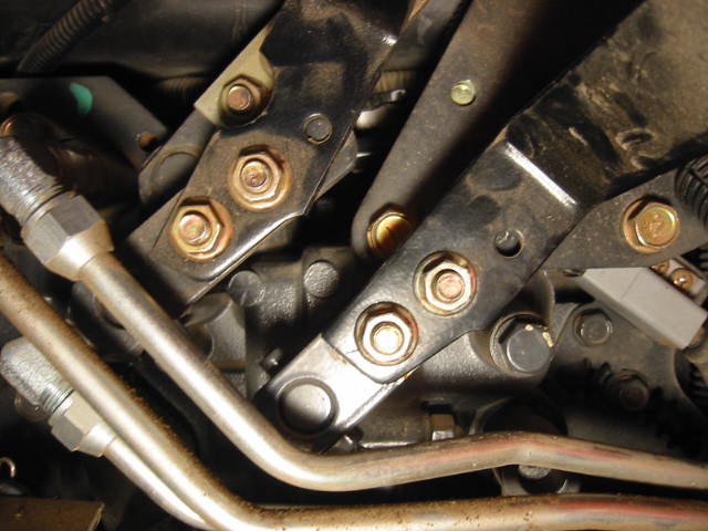

Photo at left is before adjusting. Notice the linkage at the left. That is the Range Gear Shift Lever (Fast-Neutral-Slow). Above the two bolts that attach the shift lever is a little hole which needs to line up with a matching raised "bump" punched in the metal shaft behind it. When correctly lined up the two pieces are at an angle to each other. You can see that the 4 wheel shift lever to the right is not angled, but is straight in relation to the piece behind it.
I simply loosened the two bolts and lined the hole up over the bump and re-tightened. Now both shift levers have a similar angle...a small adjustment, but makes all the difference in the world. Now when I shift into 4 wheel, it stays there! :)

Great information!!! I have a new B3200 and it has been a struggle to engage and disengage the 4WD. I thought maybe "that's just the way it is." Now, I'm thinking that I can go home and check underneath like you did, make the adjustment and solve my issue. Thanks for posting. I'll update what I find.
