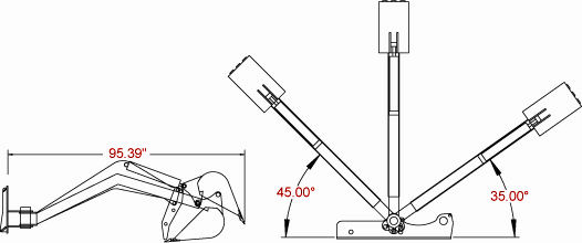

   / Fixed Skid Steer Backhoe on Tractor Loader? #2
Believe you answered your own question within your post. It might function in sandy soil. The point in which you encounter excessive stress, might be simultaneous w/ a damaged loader.
   / Fixed Skid Steer Backhoe on Tractor Loader? #3
You won’t be able to see what your doing very well if at all, and you will be doing a lot of forward and back while turning to dump your spoils. Along with what was said in the above post.
   / Fixed Skid Steer Backhoe on Tractor Loader? #4
Yeah, I could see digging (a little) with one on a Skid steer, with the visibility and the ability to counter rotate the tires to move the bucket sideways to dump, but on a tractor, no way.
   / Fixed Skid Steer Backhoe on Tractor Loader? #5
It would be a nearly useless tool on a skid steer, but a big skid steer will at least take the abuse. There’s no way I’d use it on a tractor. Bending a cylinder is nearly inevitable.
   / Fixed Skid Steer Backhoe on Tractor Loader? #6
There is also a side swing style, but I wouldn't use it on a tractor:
