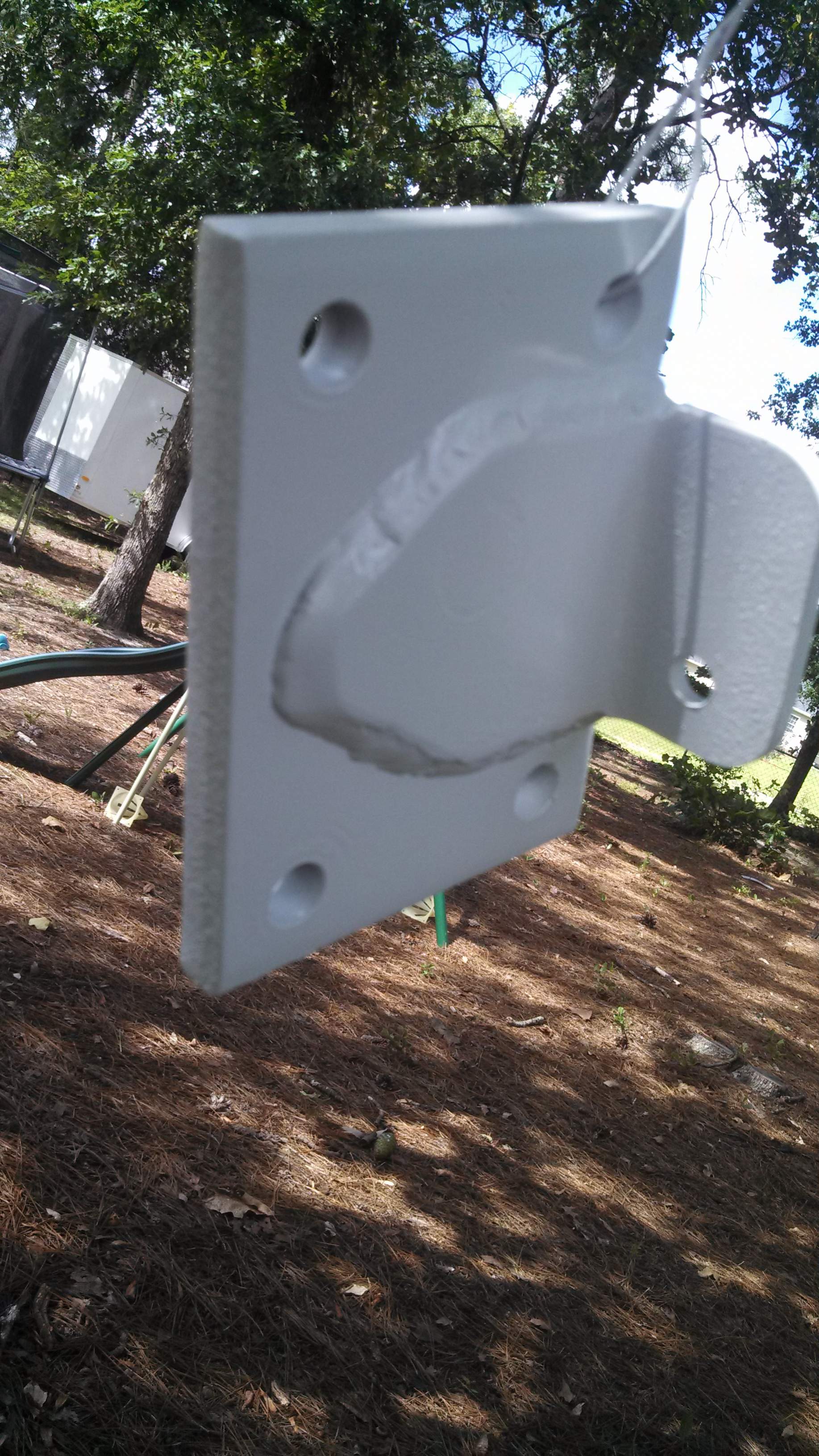

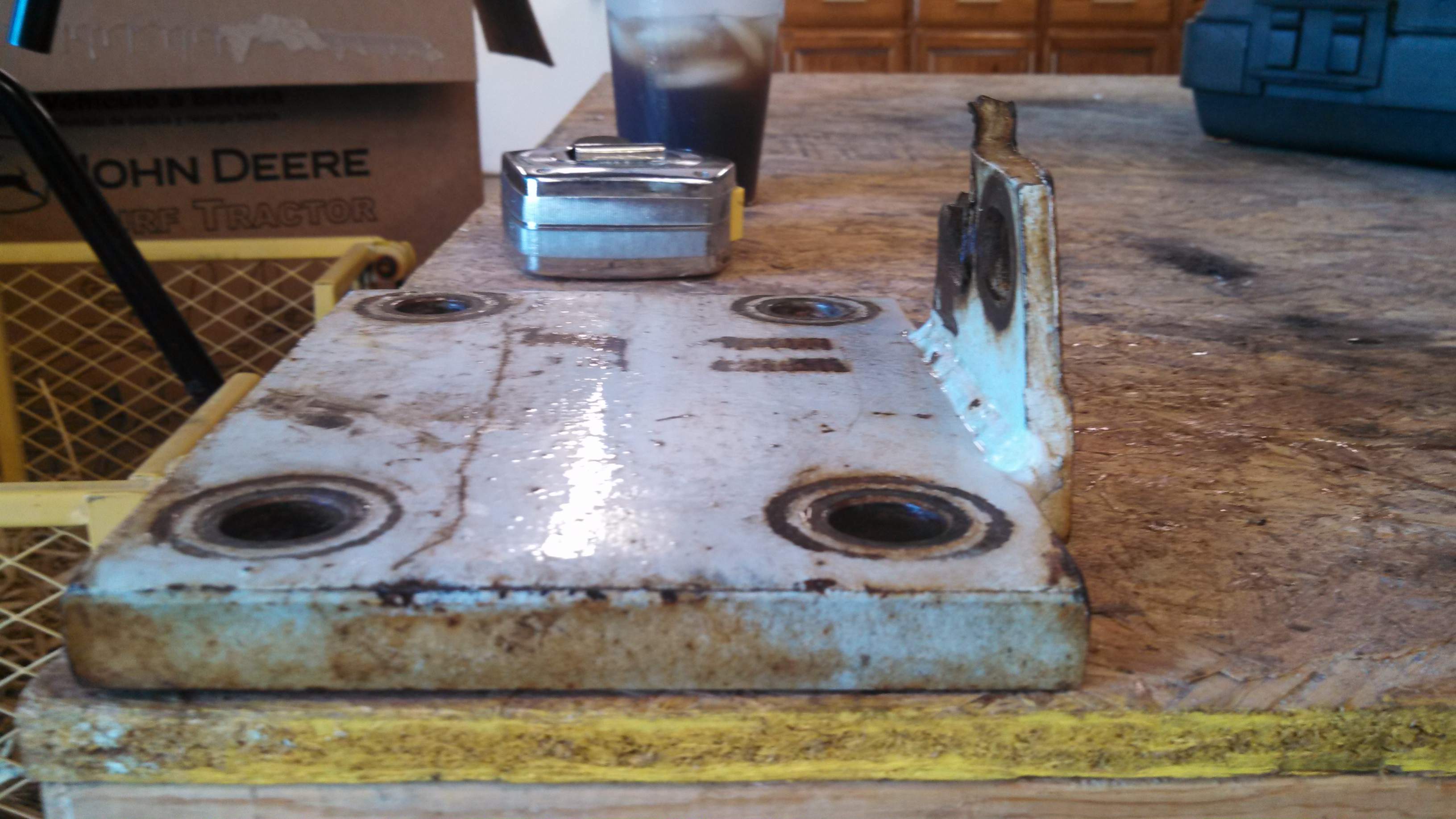

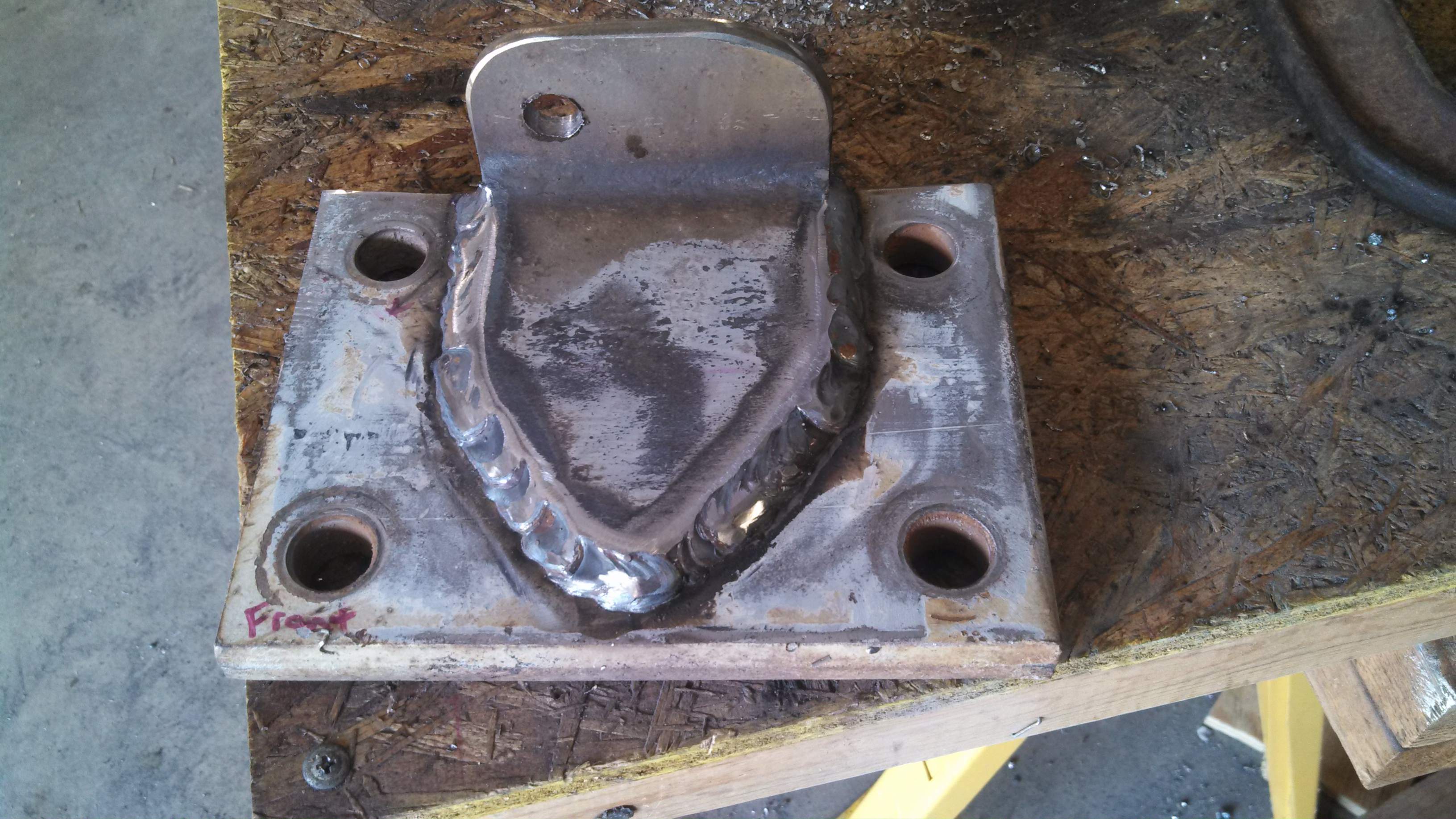

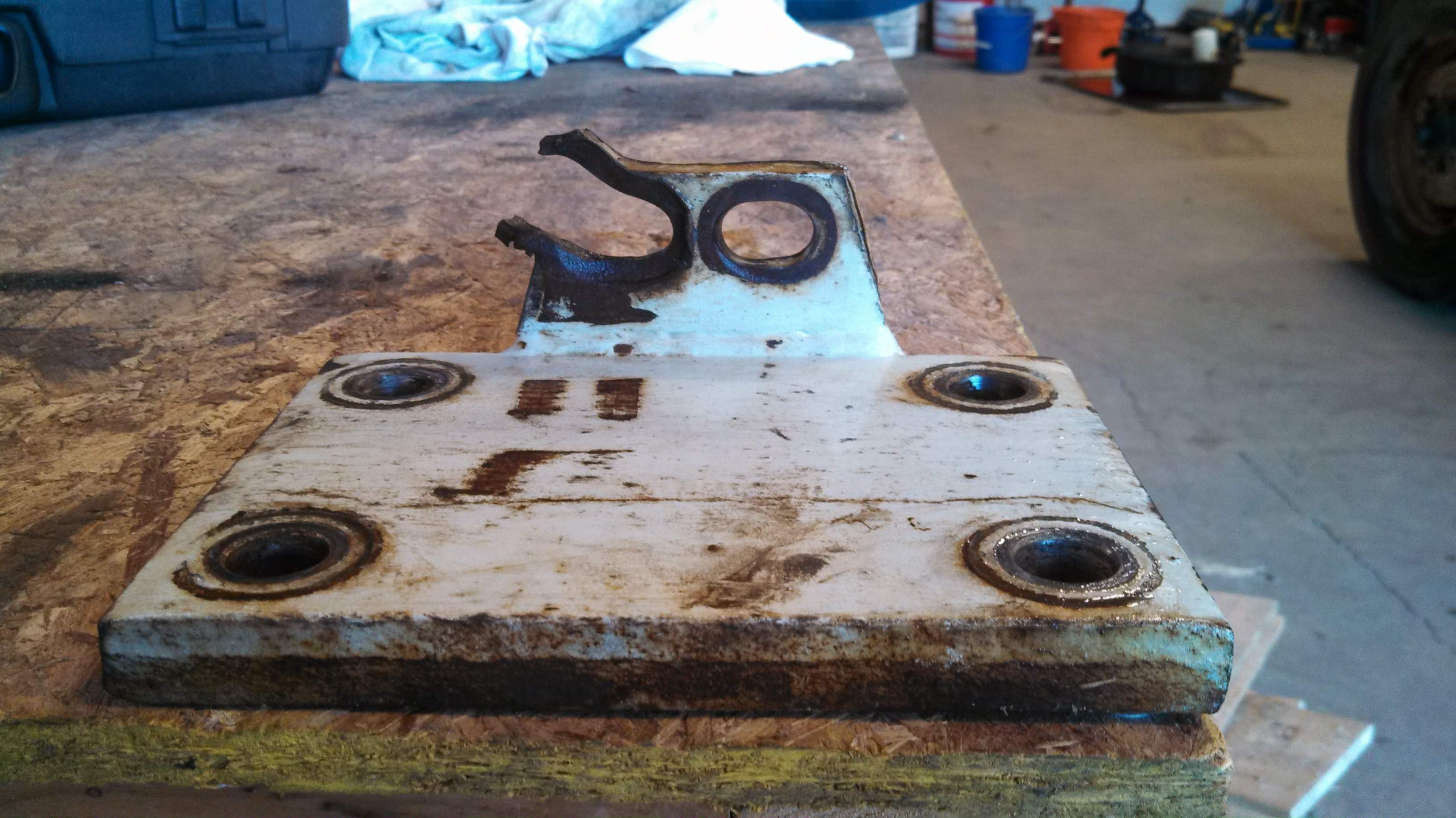

Jul 19, 2013 / Fixed stabilizer bar links today. #1 FourSonsFarm New member Joined Jul 9, 2013 Messages 18 Location Pine Ridge, SC Tractor 1973 Ford 3000 Gas The previous owner of my Ford 3000 had let the stabilizer pin get loose. Over time the hole got wallowed out and tore the 1/4" plate steel. Got the old bracket cut off and a new one fab'ed up. Now just waiting on the paint to dry. Hope it works!

Jul 20, 2013 / Fixed stabilizer bar links today. #3 Soundguy Old Timer Joined Mar 11, 2002 Messages 51,575 Location Central florida Tractor RK 55HC,ym1700, NH7610S, Ford 8N, 2N, NAA, 660, 850 x2, 541, 950, 941D, 951, 2000, 3000, 4000, 4600, 5000, 740, IH 'C' 'H', CUB, John Deere 'B', allis 'G', case VAC if the geometery is off a hair.. slot ti a bit and you will be good to go. ps.. looks nice and beefy.
