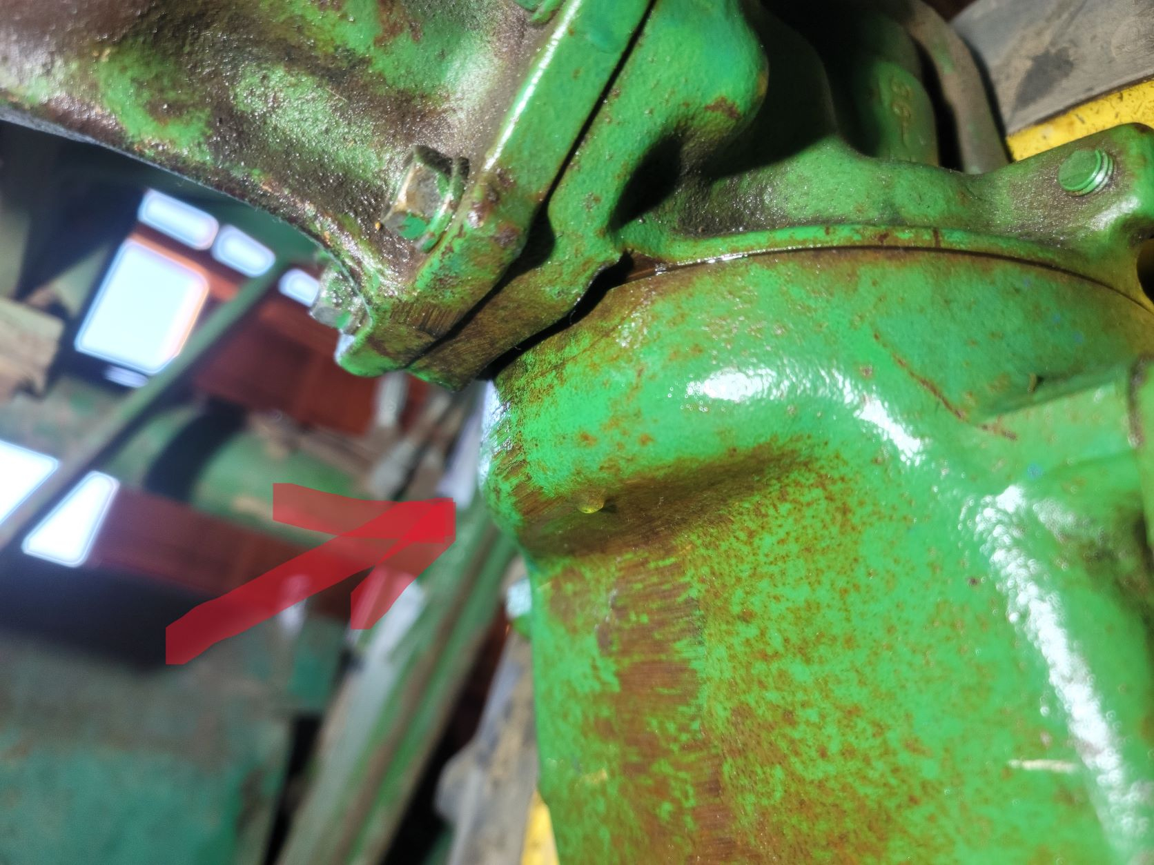

1988 John Deere 750
First post here.

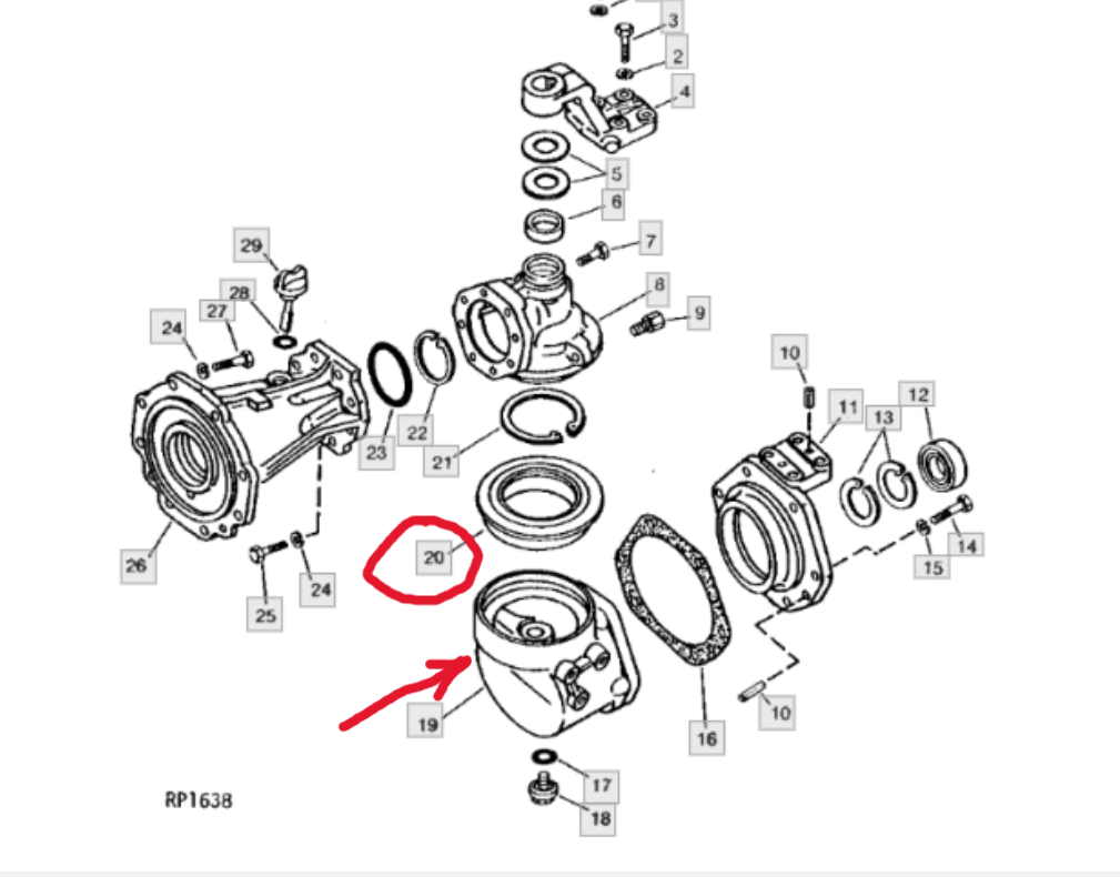

I recently noticed a lot of fluid leaking from the front axle housing. I tracked it down to the big round seal at the steering pivot (#20) on the RH side. Arrows are pointing at same location for reference.

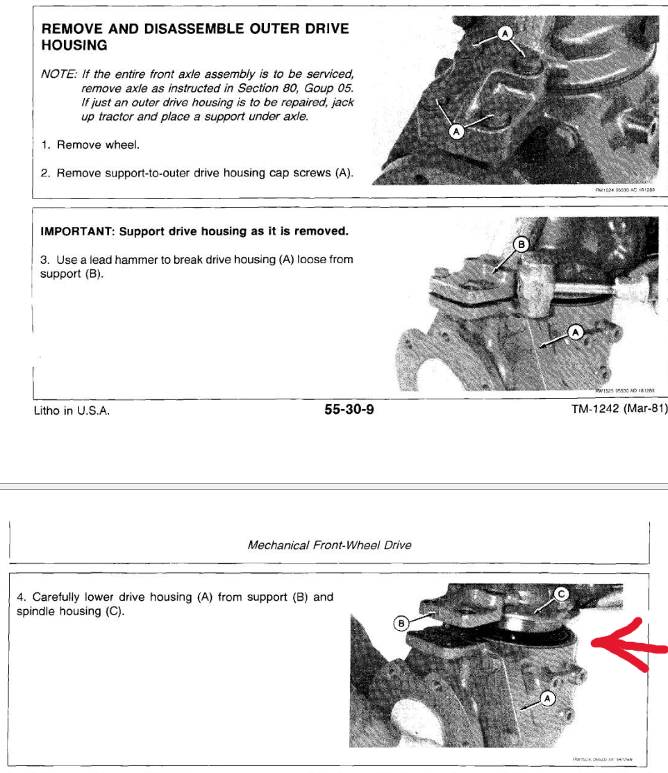

According to service manual, it looks really easy to access. Simply remove four bolts and drop the tire/hub assembly down, replace seal, insert assembly and torque four bolts.
It looks like the vertical portion of the drive is keyed on one end or the other and just slides in/out. Is it really this simple? Any tips or tricks to complete this repair?
I already have the seal. Just waiting for a little time and a second set of hands to go help me with it.

Yep, its how Yanmar engineered it. It's a simple job.
As for the 'lead hammer' a good hard mallet is best to use. These Yanmar made CUT Deere's are 40 years old. Breaking anything as important as this would be a headache finding OE parts. Use Deep Creep to loosen the area up. Even the bolts. PB Blaster isn't going to get in tight high torqued bolted locations like Liquid Wrench or Deep Creep.
When you torque up the bolts. criss-cross pattern in 3 stages. 1 position parts and finger snug tight equally, then socket wrench, then socket torque wrench till the proper In-LBS or FT-LBS or Nm requirements. Deere is English and Yanmar manuals are in Nm metric for this job.
