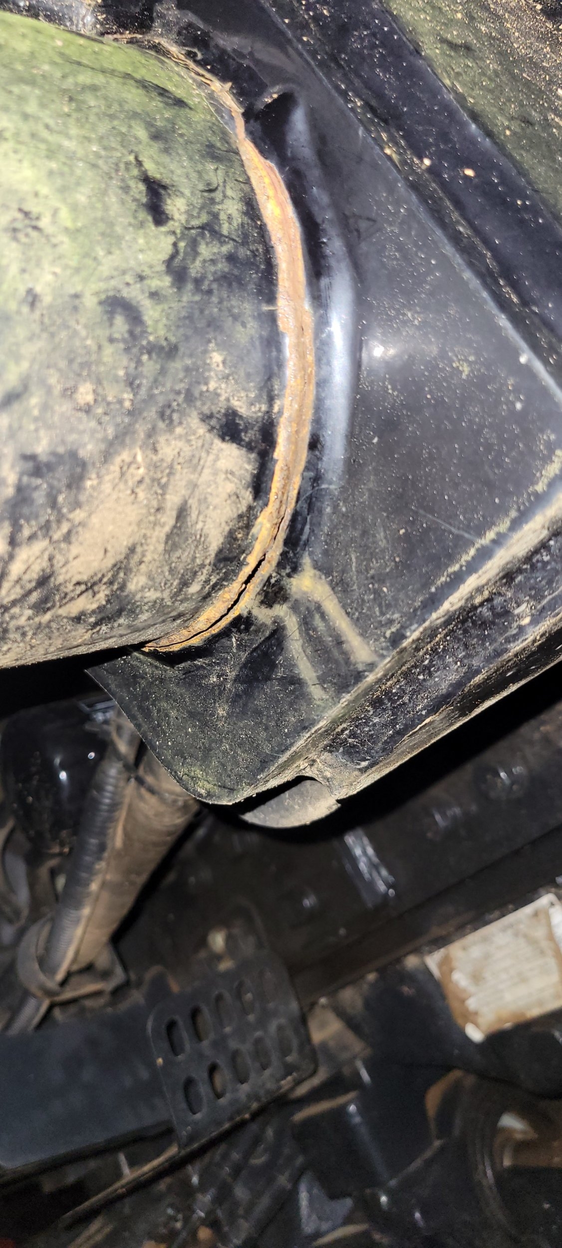

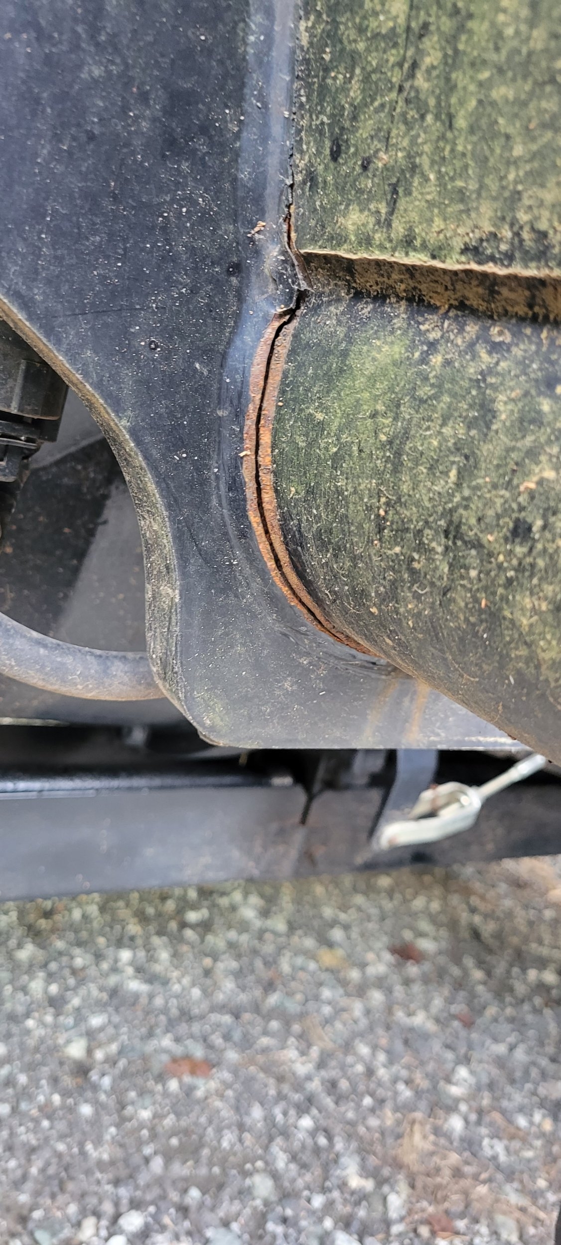

How would fix this busted weld? This is the loader support bracket on a New Holland Workmaster 60. I think it's been broken for a while but I never noticed it.
I was thinking remove the loader and pull the bracket off the tractor frame so I don't have to weld upside down. I'll be using an old 200 amp Lincoln with .035 ER70S-6 wire and 75/25 argon.

It might be worth a trip to the local welding/fab shop with a "heavier" welder, especially for this major load area. The last thing you want is to do this again. Oh, and I suck at vertical and overhead also. 😆
   / Fixing a New Holland weld #3
I would clean it up and tack it really good while still mounted. Then remove for welding up solid. Slow and steady is the key here.

Go for it. Grind it out, crank up your welder and make a few passes. It’s not a critical joint, keep an eye on it and address it if it cracks again. Looks like the original weld didn’t have any penitration.

I take this "loader support bracket" as the mounting of the loader "tower". If it is, that's as critical as it gets on a FEL. It'll make a huge mess of the bracketry if one side lets go and probably involve sheet metal and more.

No reason why you can't MIG weld it. Like others said tack it before removing, clean it up real good, turn it up to get good penetration and go slow. Take a good pause on the left and right sides of your bead. The main thing is penetration. A few passes over-lapping about 50% want hurt. I would also look at the other side and make sure it has good penetration. If you don't like the what you see you can always take it to a shop or have someone weld it in place. Good luck!

Biggest downside to MIG is lack of penetration with the machines commonly used by hobbyists/part time welders. A MIG machine that'll do that right costs $2000+ used. A stick machine that'll do it costs less than $500.

I have to disagree with you, that a $2000+ must be used to get proper penetration with a MIG welder. I have properly welded plenty of 5/16" inch thick steel with my 115 Lincoln SP125 PLUS MIG welder. By properly I mean the proper amount of penetration. The way to do this requires pre-heating the work before welding.

Could be. I haven't tried that. Couple things though. One, preheating something like that is going to be quite the hassle, and two, I'll bet that tube is quite a bit thicker than 5/16. Anyway, as Arayt reminded me, the OP has a 200 amp welder, so he/she should be good to go. (y)
