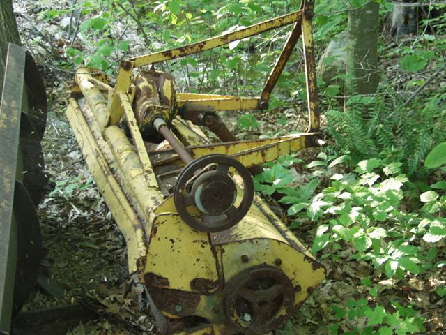

I picked up this mower last fall cheap. Need to get some parts and I am unsure of what it is exactly. The person I bought it from listed it as a 5' Mott mower, but it is at least 6' long.

Another shot.

Looks like my Mott mower. The folks at Flailmaster (www.flailmaster.com) can hook you up with an illustrated parts breakdown and have a good selection of reasonable parts available. Before you call, measure the width in inches and count how many sets of flail blade pairs you have, that will help them zero in on the exact model.
If you put in new bearings, belts, idler, teeth, etc. you will have 4-500 bucks invested. A new many is several times that, so still a good deal, they are nice to mow with.
