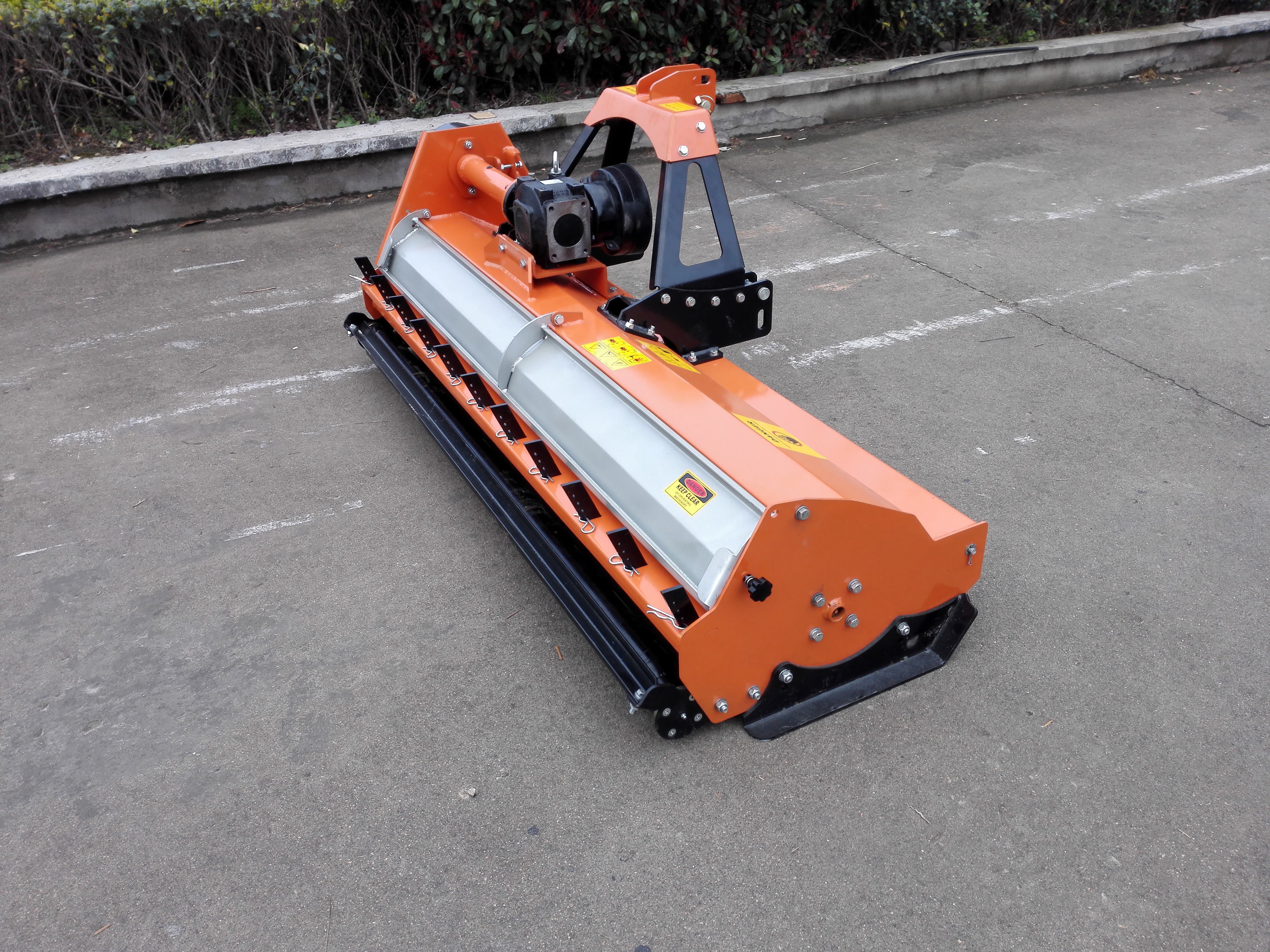

Hello. I contemplating to buy a flail mower, similar to the one attached on photo (chinese made) My tractor has only 20 hp with FEL, so I can't go too big.
Will it helps me to deal with this type of grass (on attached photo) and small trees (1-1.5 inches diam.) ?
Can you share your techniques with dealing with such a bushes?
Thank you

That is a bit too tall for a flail. Flails do a good job of basically mulching the grass to small bits, but it takes a lot of power. For grass that tall and thick, I don’t think any flail will handle it well. Not to mention, you would have to drive the tractor over the grass first. Flails do not work worth a darn moving backward.
I have a commercial Italian ditch and bank flail behind a 70 horsepower tractor, and I don’t think it would handle the grass in that picture without stalling the engine of the tractor.

:thumbsup: . . . I agree that is some tall and thick vegetation . . . no way 20hp is going to cut it.

I never had much luck with Tall LUSH vegetation using any variety of flails. I would wait for the vegetation to dry out, and cut it in the fall.

I have one location on the property, going around a pond, that does look much like that. I used to have a friend with a walk behind sickle mower cut it first. Now, I find, my Cushman ten foot wing mower will go through it after all. Sometimes you have to go back and forth, but seldom.

Correct. it's never dries out and I am at 600 m elevation, so often clouds have their gathering up there, fog, and drizzle rain especially in the winter.
What would you recommend to deal with such grass?
So far I will be using FEL to dug it out and push it to the side

Bush hog, rotary cutter. I've got a Kubota B7800 that I first used to tame some Reed Canary grass, grass that I'd measured stalks at 10 1/5' (yes, TEN and a Half FEET). Very slow going, but one can get the job done if patient. Once somewhat under control one can then use other cutters to maintain: I still rely on my rotary cutters (5' and 6') to do my mowing as I continue to do brush clearing work- one day hope to switch to using flails (for at least one of my tractors). A 4' cutter is about all you're going to be able to run on that tractor; back in to the grass/brush (if only grass then one can go forward over it: no potential harm to tractor).

It's going to be tough going at first (I spent some time there years ago, more so in SEA, Vietnam) . . . bulldozer at first, if you want to get it cleared fast . . . and then maintaining with your tractor. How many acres are we talking about? You're in the highlands then . . . things grow like some kind of aliens there . . . :eek:
