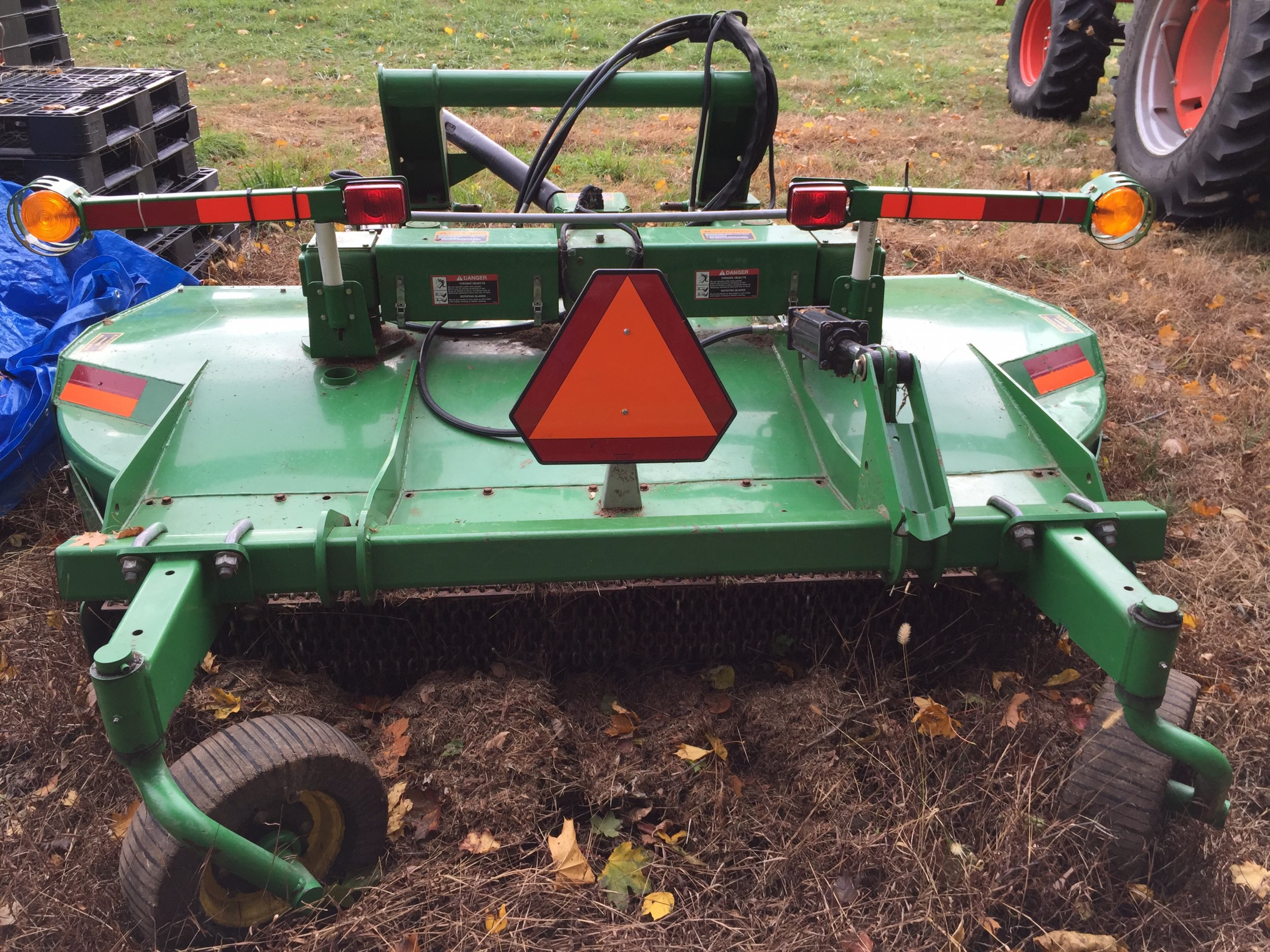

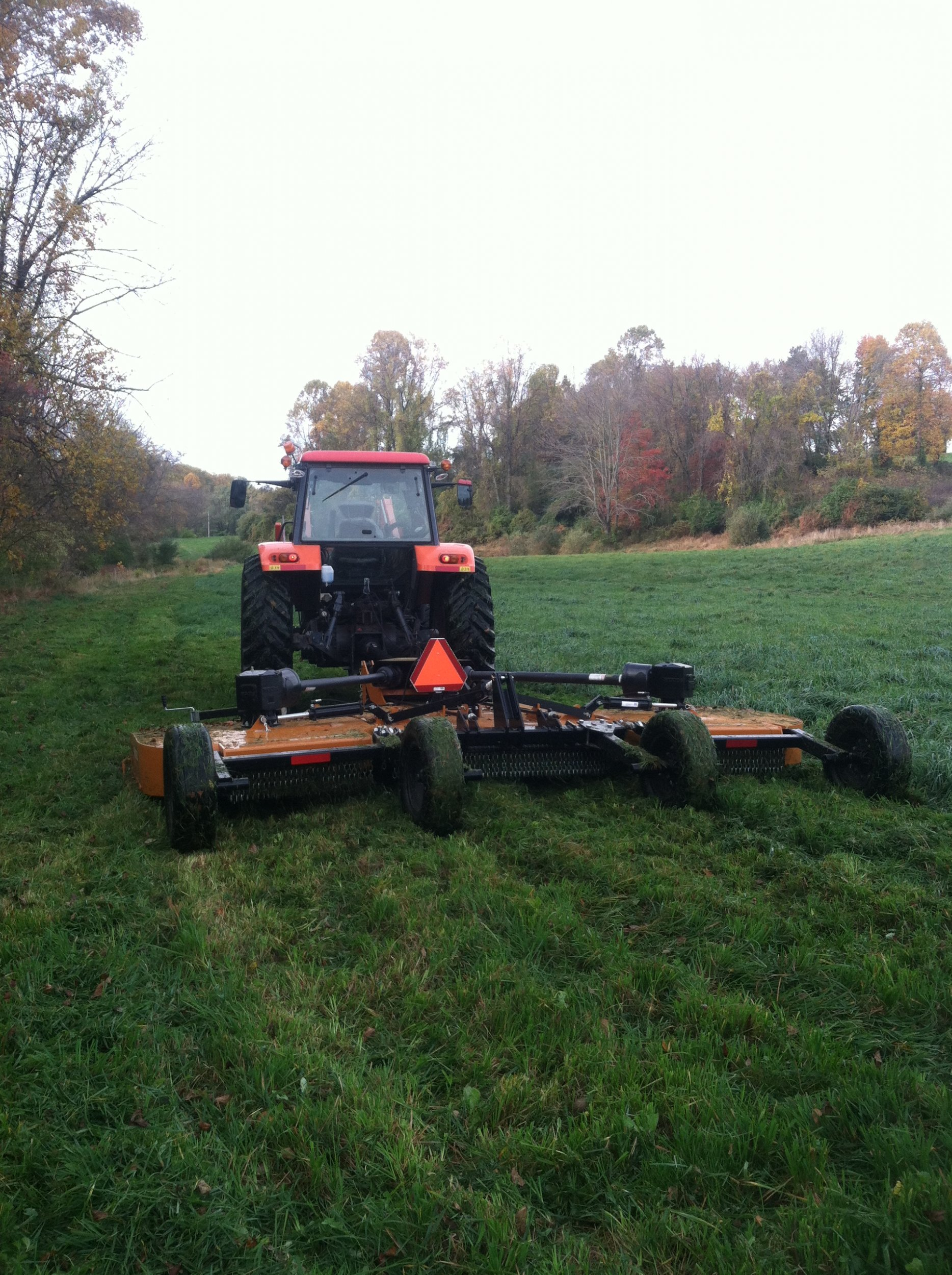

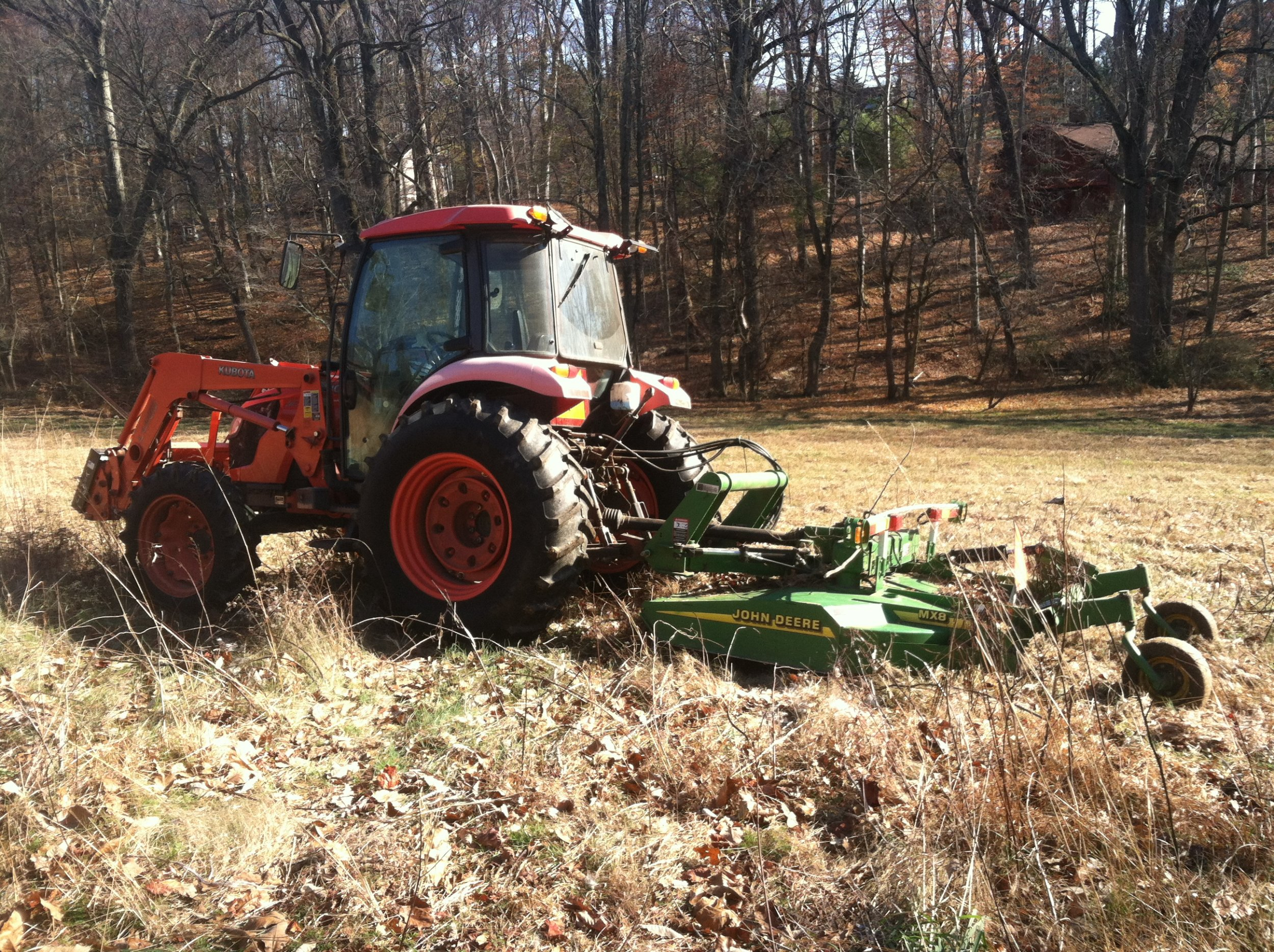

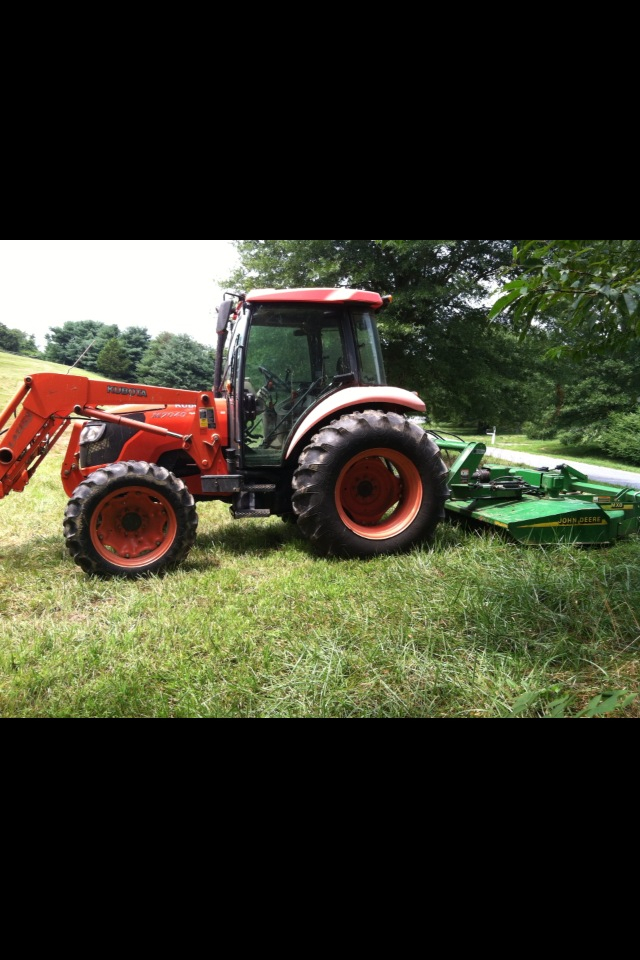

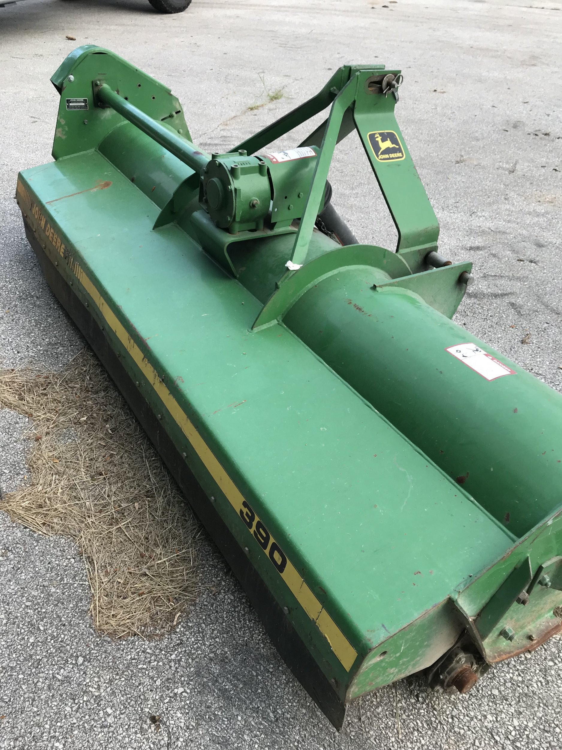

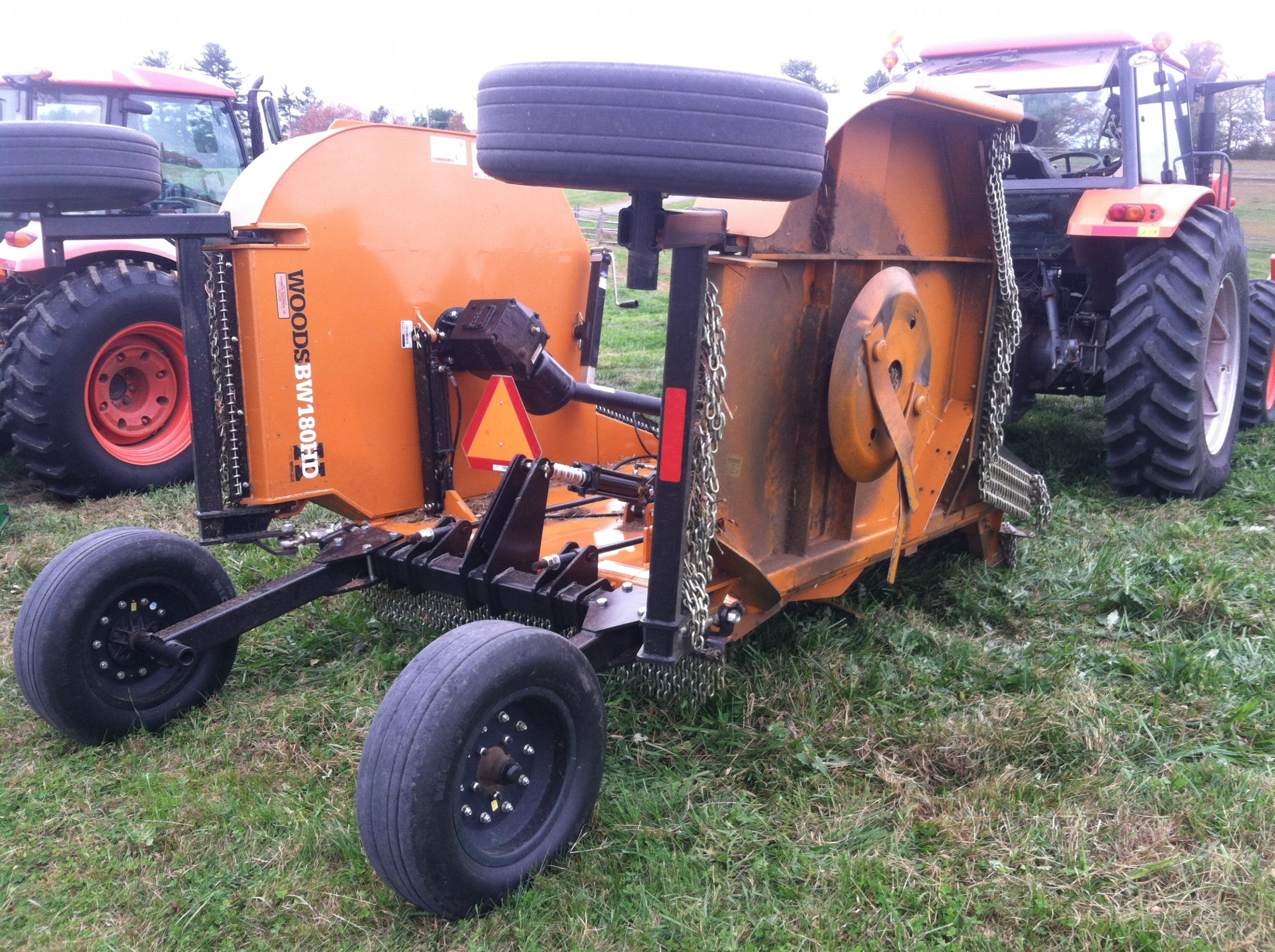

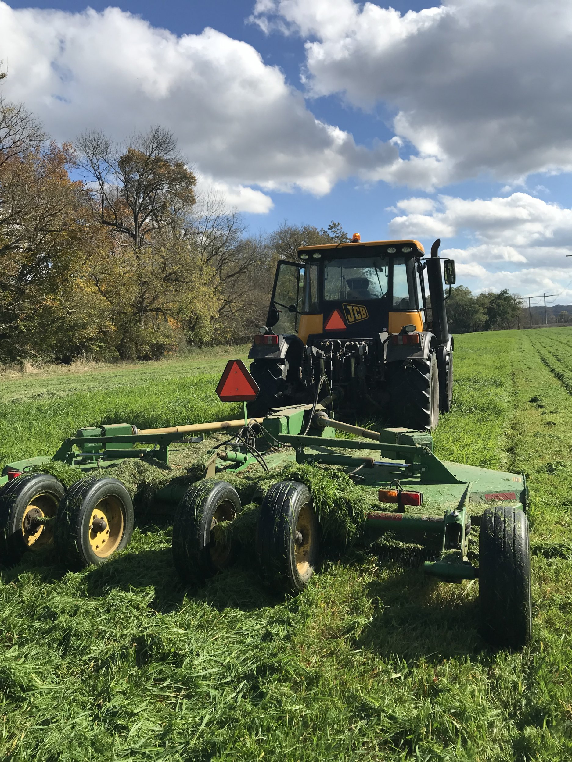

I have a custom mowing business. Hay & large fields and a few smaller fields. Have owned several mowers flail (John Deere 390 and Ferri swing arm flail) & rotary (John Deere CX & Woods Batwings) over the last 20+ years. Flail mowers are nice, but I didnt care for the extra maintenance on all the tiny hammers and had some issues with belts. A bush hog type of rotary mower is all shaft driven and pretty easy to sharpen the blades.
As you said, Flail mower less likely to throw objects, but my rotaries (John Deere CX series) have chain shielding and it works great. In 20 years I cant remember ever throwing anything in a dangerous manner through rotary chain shielding.
The flail is more compact and closer to the tractor for backing. How important is that to you versus the ease of service and ruggedness of a HD rotary?
Over the years, we have eliminated the flails from our fleet of mowers and are now all rotary. However, I can understand the attractiveness of a flail.

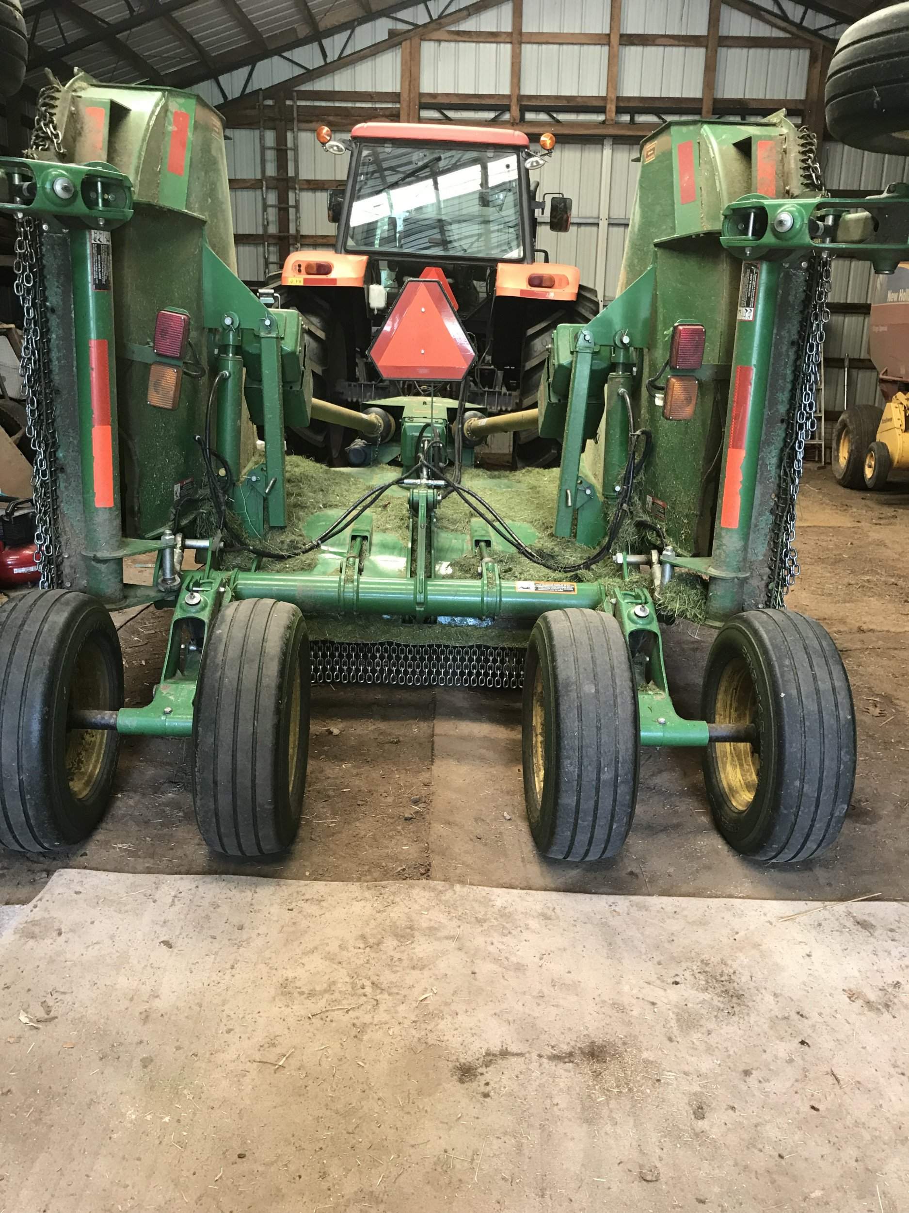

If you can find one of these, BUY IT. John Deere MX-8. Ran this thing for 7-8 years in way rougher ground and conditions than recommended and it never needed repairs.
They are fantastic for use around trees and split rail fences. I used this on my cattle pastures under fences and it does an amazing job. It side shifts to the left or right 2 feet!
