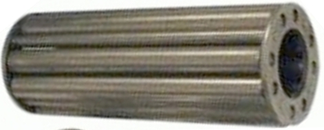

For what it is worth the towed unit will give you a closer cut as the suspension uses a twin screw height adjustment.
The integral mounted flailmower has the rear roller which will keep the mower from scalping the sod versus the four wheel towed unit.
