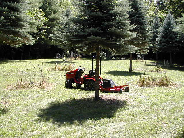

Here's some results from using my Honda 5518 and Honda Brush Hog.Although I just bought a Kioti DK35 and a Woods BB60,I find myself going back to the Honda.It will mow grass and weeds from 8" to 3'+.Also chops up the brush pretty good.I havn't seen the results from a Flail cutter but I have been pleased with the resuts of my brush hog.
Rick

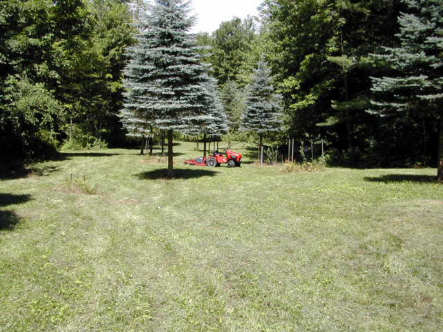

Here's another picture.
