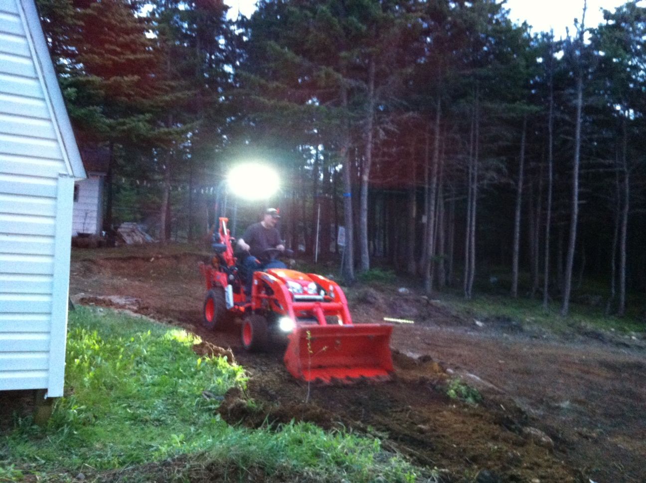

Has anyone put an LED light bar on the roll bar to use a a work light?
   / Flashing light on bx23 #9
Should be a work light connector, red and black wires just rear of the bottom of the seat, over the tank. Check for 12V with a meter. It is switched on with ignition as I recall.
That's where the hook-up is. It switches on with the headlights tho
   / Flashing light on bx23 #10
Yup :D
Front led light bar .
Rear, white and amber led 70 pattern strobe

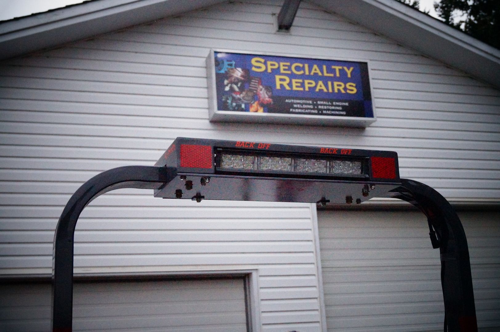

Can you give me the details on both the light and strobe? Do they work great? Is the strobe just a strobe? I would like to do this. It looks to me like you made a mount that hold both lights as well?

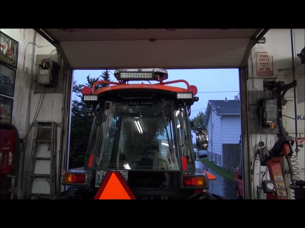

Glenn the rear portion of the light module I built has (if I remember correctly) 70 flash patterns. One half of that light is amber and the other half is white, by toggling the switch you change the patterns but there's one that will keep the light on steady so it can act as a back up light.
The forward portion of the light module is a single row led light and it's super bright.
The module itself is fabricated out of aluminum plate and held on the ROPS via ubolts. I designed it as you see it because I was trying to achieve the lowest possible profile as I could build. I'm happy with with it and it really works great. I'm not a fan of having individual lights bolted to the ROPS so that's the reason I went this route.

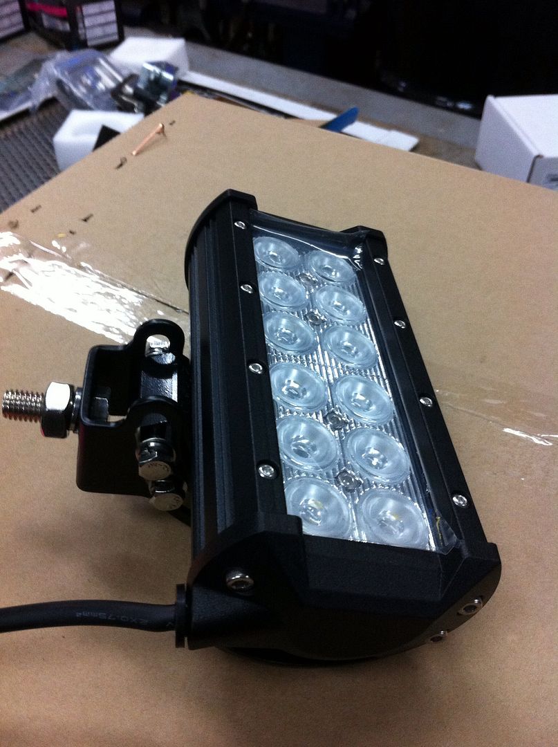

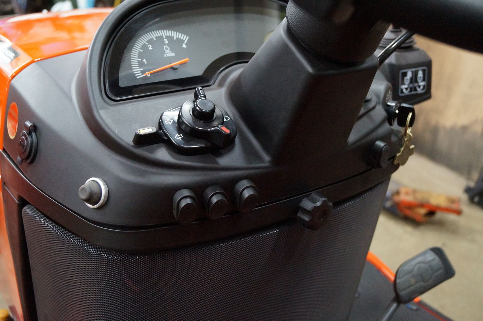

That's exactly what I am looking for. Can you let me know where you got the lights? I would like to order them. Where did you mount the switches? If they are fed by the wire under the seat I would guess you need to run some wiring up front if the lights are dash mounted?
   / Flashing light on bx23 #14
Well I've bought sooooo many lights in the last two years I'll have to check our files to see if I can find that info. I've not only modded this little BX but I've done our Kubota Grand L 5740 and believe me there's a lot of led lighting on it.
If you go back over my mod thread I might have mentioned where those lights came from. I can tell you that the rear strobes are controlled via switch down by the 3pt hitch dampening control (see photo) the rest of the lighting is controlled via switches on the dash. I ran an extra fuse panel, relays and custom wiring harness to do it.

Glenn when I'm looking for led lighting I look for the following. Grote, Rigid, Whelen and last but not least Cree. If you stick with those brand names you'll be ok. I NEVER had an issue with any of those products.
