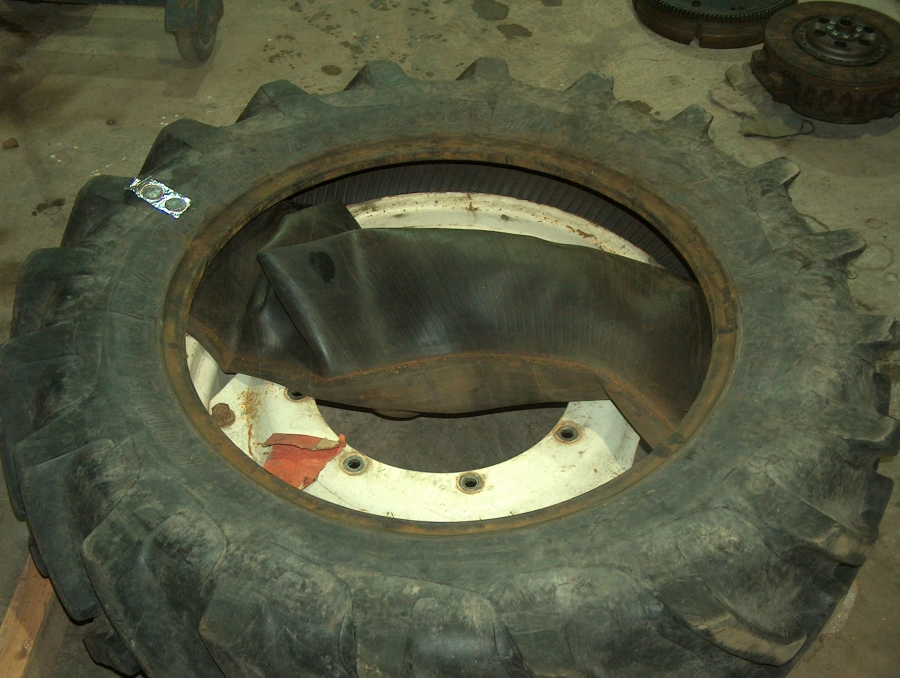

Had a flat tire the other day, a nail standing nicely in the front wheel of the Fiat.
I was just about to take the wheel to town to get it fixed, when the wife said she would join me, some errands.
Panic,- said I probably would fix it myself.

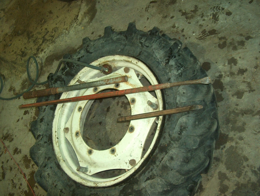

So I did, not that much work. Hardest bit is to loosen the tire from the rib. You can use the FEL, drive over the wheel with something heavy, or use a tool similar to what I made, a rod that fits into a tube with a weight at the end, seen here (dekk1)

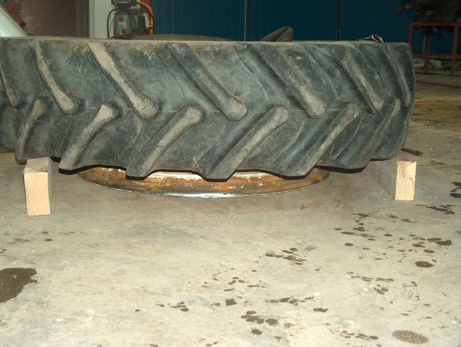

Loosen both sides of the tire from the rim, then put the tire on the floor, valve up, with two 2x4 under the tire, allowing the rim to fall on the floor (dekk)

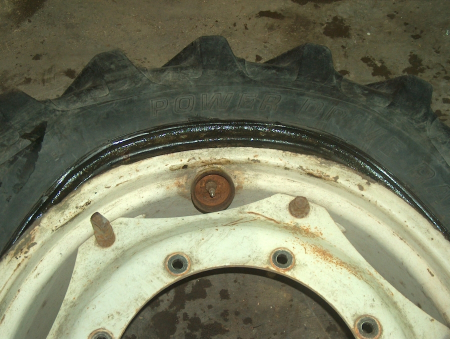

Then press the part of the tire across from the valve into the center of the rim and start breaking the tire over the edge of the rim near the valve, with a couple of rounded bars. Pull out the tube, fix it and put it back together in reverse order, remember to lubricate the rim and tire so it easily will glide back where it belongs when you fill it with air(dekk3)

Nice job. The tools you made look nice. I've used a high lift jack under a truck bumper to break them down before. Just use a shop hammer to knock the foot back against the rim as the tire bead starts to go down so it doesn't slip. Crow bars make pretty good tire tools, just don't stick them in too far and catch the tube or have any sharp edges on your tools or you will have more holes to fix.
The only ones that get really hard are the tires that have been on for years and rusted to the rim. Those are actually probably worth the price of a tire shop, just so you don't have to fight them.
   / Flat tire #4
We used to use flat car springs for prying off the tire. A hammer and a heavy dull chisel for breaking the bead.:D
   / Flat tire #5
A backhoe makes a dandy bead breaker. A pickup truck works in a pinch.
   / Flat tire #6
And a rubber mallet is handy for putting the tire back on the rim instead of prying it on.
