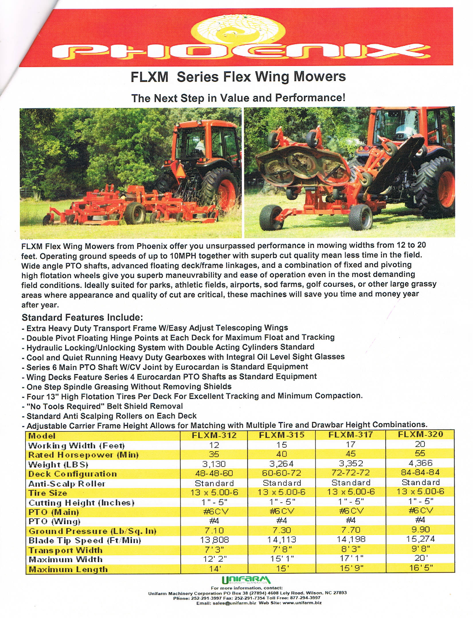

Here are the specs of the Sicma/Phoenix that we sell. Ken Sweet
