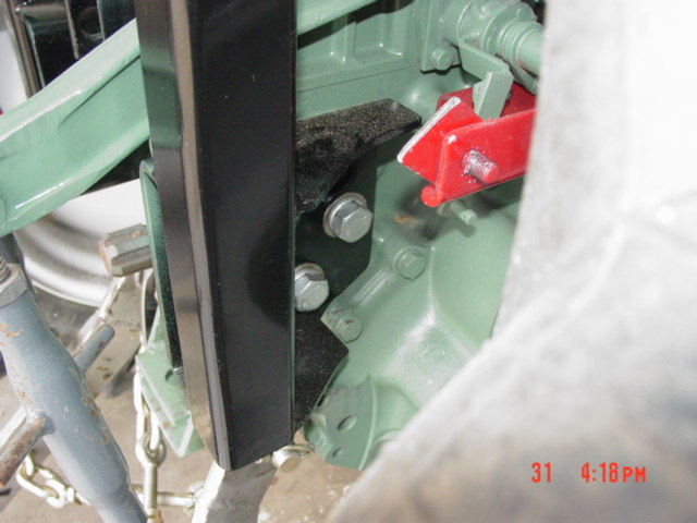

I went there looking for some shorter 16mm to mount my ROPs........Home Depot also stocks 'em.............
   / Flipping rear tires around #5
What thickness is the bracket for your ROPS and what length bolt did you use?
   / Flipping rear tires around #6
Oh boy, if memory serves, it's about 3/8" thick metal, and I believe I used a 40mm long bolt. Sorry to mix my measurements...............
Here's a pic
