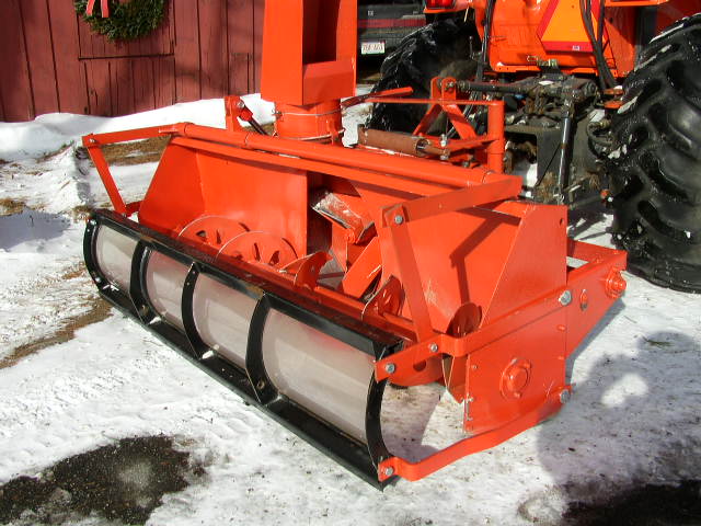

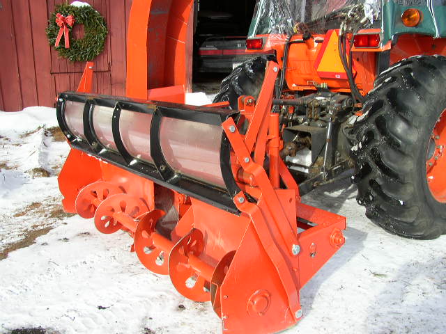

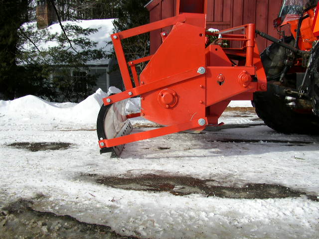

Sometimes an implement needs it. Here's a 3-point snow blower with a drag blade for cleaning up close to obstacles. The remote for up/down has float so blower and blade can move independently.
