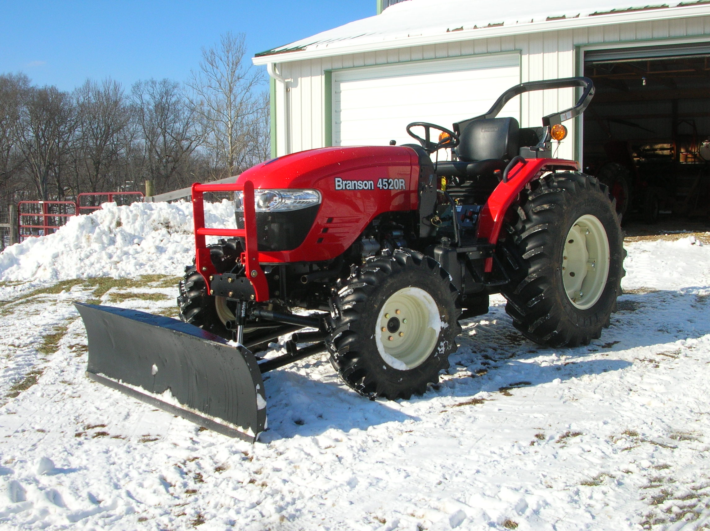

I cleared 30" of snow from 10 long driveways, some gravel some paved, using a snow bucket with edge Tamers and I only lifted the front tires once and that was with a 1200 pound counter weight 5 feet behind the rear axle. I removed the counter weight and replaced it with 450 pounds 18" behind the rear axle and with that could push in float forever or until the tires would spin (depending on drift height and grade).
Bottom line, if your lifting the front in float move balast forward on the tractor.

It's a little tough for me to move ballast around as I have a backhoe as my rear weight. I'll be loading all 4 tires next week in hopes of increasing traction. That will also put another 160lbs at the front wheels.

Sorry, didn't realize you had the backhoe. No doubt the BH is making your front light.
Filling the fronts is a good idea. In addition, you could also add some weights to the frame in front as long as you are creative enough to do it without interfering with the loader.
How hard is it to remove the backhoe?

Backhoe on/off is pretty easy, but I've got nothing better to put on the back for weight to support moving firewood pallets around so configuring the tractor for each task I perform in the winter gets a little too complicated to swap back and forth fast.

The backhoe will make the steering worse when plowing.
I left my backhoe on one time plowing snow. The front end just wanted to push with the snow blade angled and it did not want to steer.
I now never plow with the backhoe left on.

If U want the ideal tractor plow you'd want to have long arms back to the rear axle that the plow would be mounted on.
That would result in what I call a 'straight line push' coming from the best traction area of your tractor.
Recalling basic hi school physics, 'for every action there is a reaction', the more snow piled up front, the more force pushing backwards.
If you are not pushing in a straight line that snow load wants to push your front upwards and you end up with less steering as the front gets lighter.
Also the further your plow is from the front, the more effect that snow load will have on pushing you sideways.
The answer is close as possible to the front plow and push arms parallel to the ground.
I made my own plow, low mounted, straight push and can plow just as fast and as easily as when I drove a diesel plow truck.
My tractor (MT180D) is 4' wide and my plow is 6' and I have no problems curling snow off to the side flat out at my max 8mph. LOL.
