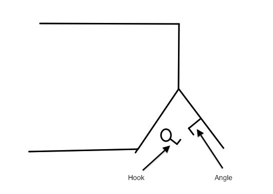

Based on my use, yes. I have a Cammond that requires me to reach under the rear blade to lock/unlock. Sort of a pain in the arse to do with any frequency. It's a great 'blade, and at 66" a perfect match for my machine. That 66" size was rare in this weight and a deciding factor in my decision to buy (hint-hint). I've been thinking about cutting up a 3pt quick hitch and using that mechanism to lift & lower a pin to lock/unlock the blade:
This would require getting the vertical actuating links across the horizontal hinge - a challenge, but not impossible. I don't see why the hinge can't be "segmented" in the 2 locations where the vertical actuating links would need to cross.

I would not want a floating tailgate that couldn't be locked down. Locking it down means you have two fixed surfaces instead of one, and the box blade works MUCH better for fine grading because of that, at least in my experience.
Think about it. Most of the box blades out there have a fixed tailgate that is essentially the same thing as a locked down floating tailgate. I would not want to build and market a floating tailgate that couldn't be locked down. The competitors will use that missing feature to sell against you. Especially when the reason for not being able to lock it is to "fix" a problem that doesn't exist.
Unlocking it allows the front blade to dig in much more and is better for moving large volumes of dirt, especially if the box blade is tilted forward somewhat with the toplink.

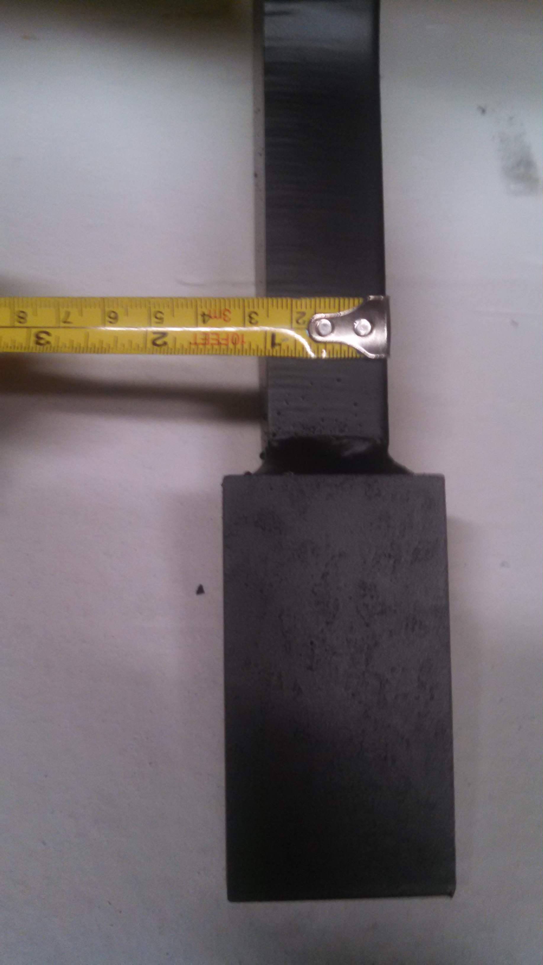

We have found that they just don't make scarifiers like they used to. I've been talking to Ted about this and, for this boxblade, I think we're going to make our own, rather than settling for "off the shelf" shanks. The details, as of now: 1" thick x 3.5-4" wide T1 Steel with AR400(abrasion resistant/400 tensile strength) tips. We're talking STOUT and long lasting. To our knowledge, this is something that no other mfg has offered, past or present. Travis

Unfortunately, the dimensions of the new shanks are going to be larger than the shanks that we use on our severe xtreme. The shanks that we have been using are the best that we've been able to find off the shelf and we have had very few incidents with breakage.
Travis

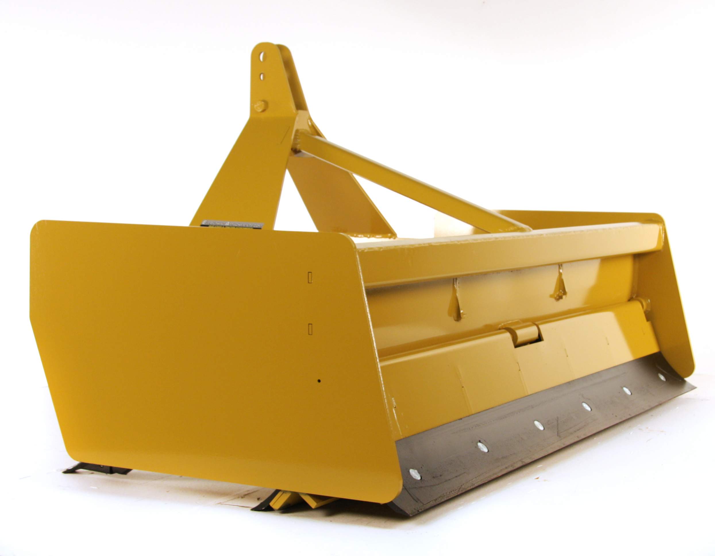

Here is the first 96" Floating Tailgate Box Blade outfitted with the custom shanks that are totally fabricated in our factory.
Ted did work it out so the tailgate can be pinned closed efficiently.
It weighs right at 1,300 pounds!!
Travis
Here are some pics:
IMG_20150119_084820_119.jpg IMG_20150119_085553_656.jpg IMG_20150119_085610_986.jpg
