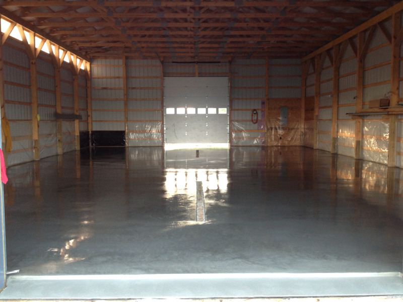

Looks slick. Be careful on it if it gets wet

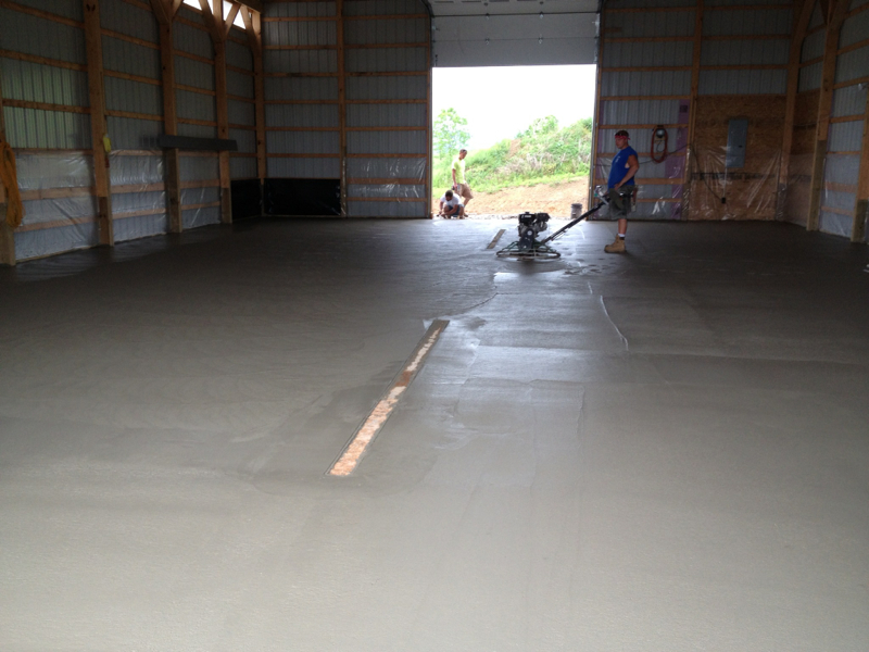

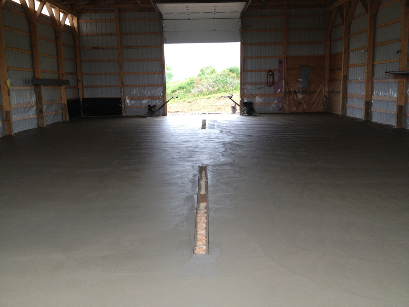

So what are the details??
How thick??
Wire or fiber or both???
What sealer??
Also, I would rent a saw (or hire it done if you choose) and cut that slab every 10' square. Otherwise, it will most likely crack.
It looks like the finishers did a heck of a job. It looks very nice.
As to moving stuff in, After 7 says its strong enough for about anything with tires. But if you have some heavy shelving with metal legs or something like that, I might wait a tad longer cause it will still scratch the surface pretty easily.
6" thick, 8 gauge wire, fiberglass, I need to see what brand the sealer is. They came back the next day and saw cut it so that's done. I just moved the tractors and some stuff in this afternoon, I figured 12 days was long enough.
It's not too bad when it's wet but it will be very slippery with snow on the bottom of shoes.
