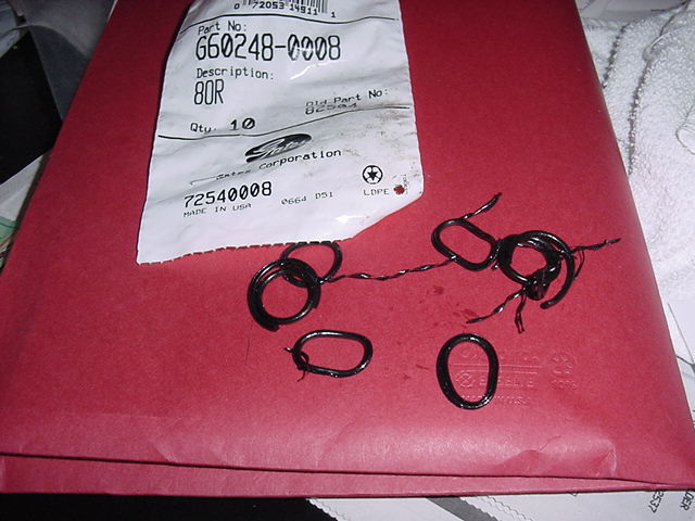

is it a Kioti backhoe? If so, mine was doing the same thing. What I found was the o-rings under the 90 degree elbows were leaking because the existing o-rongs were mashed down. So much so that it looked like they were the wrong ones. I used Gates o-rings part # G60248-0008 on all 12 fittings. Solved the problem for good. The o-ring at the bottom of the pic is a good example of how they looked

Nothing off-topic about trying to help! The leak is around the left-right boom swing valve pin (if that's the correct word) on the KB2365 left-hand control. I tightened the three allen bolts down as far as I dared - not very far - which didn't seem to help at all. I hate to pay the dealer almost $100 to pick up and drop off the machine, and possibly pay for a repair as well. It's under warranty, but he says that tightening isn't covered. (If I break off the bolts, is that covered?) I'm really curious as to why this would have started right after I had them do the initial 50-hour service, and also why the hoe boom now screeches pretty loudly when I pull in from long extensions. They said that it might be due to different greasing, but I wonder...

Chelydra,
The problem you are have with your Kioti backhoe is a very well known problem and Kioti is well aware of that problem.
You can tighten those allen bolts as much as you want and will not do a thing.
The o-ring has already been blown out.
It will have to go back to the dealer, It is ALL covered under warranty.
   / Fluid choices for CH20HST? #10
Rick
Mine did something like that, only on this one it was a bad weld at the outter end of one of the swing cylinders. Kioti replaced the cylinder and all is well again. /forums/images/graemlins/smile.gif
