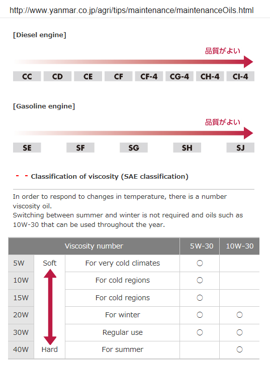

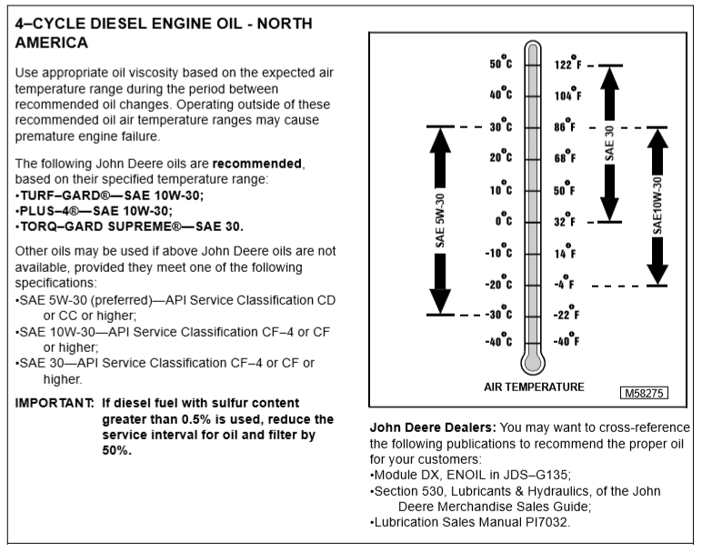

Engine oil per Deere/Yanmar,
The Yanmar engines are built to JIS standards and not SAE. Going with 10W40 or 15W40 in the hot summer would retain heat in these engines longer. It's common to see heads warp or crack operation in hot temps with those heavier oils.
Yanmar strongly recommends 10W30 Rotella T4 or T5 diesel oil for summer and 5W30 for winter in colder climates, else 10W30 in just cool climates works all year. My place sees -22F in February for snow plowing, so the 5W30 is a must.

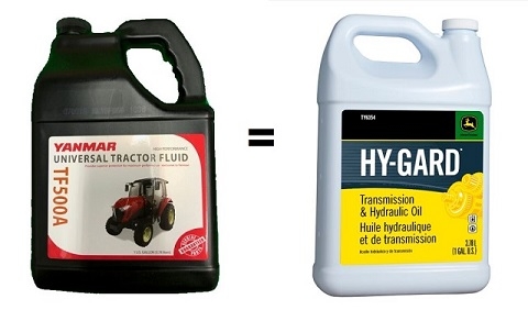

As for hydraulic fluid, be sure to buy 'meets or exceeds' J20C. J20C for the same formula is Yanmar TF500A and Hy-Gard. The TF500 without the A is J20B. It would still do the job, just sooner to change.
