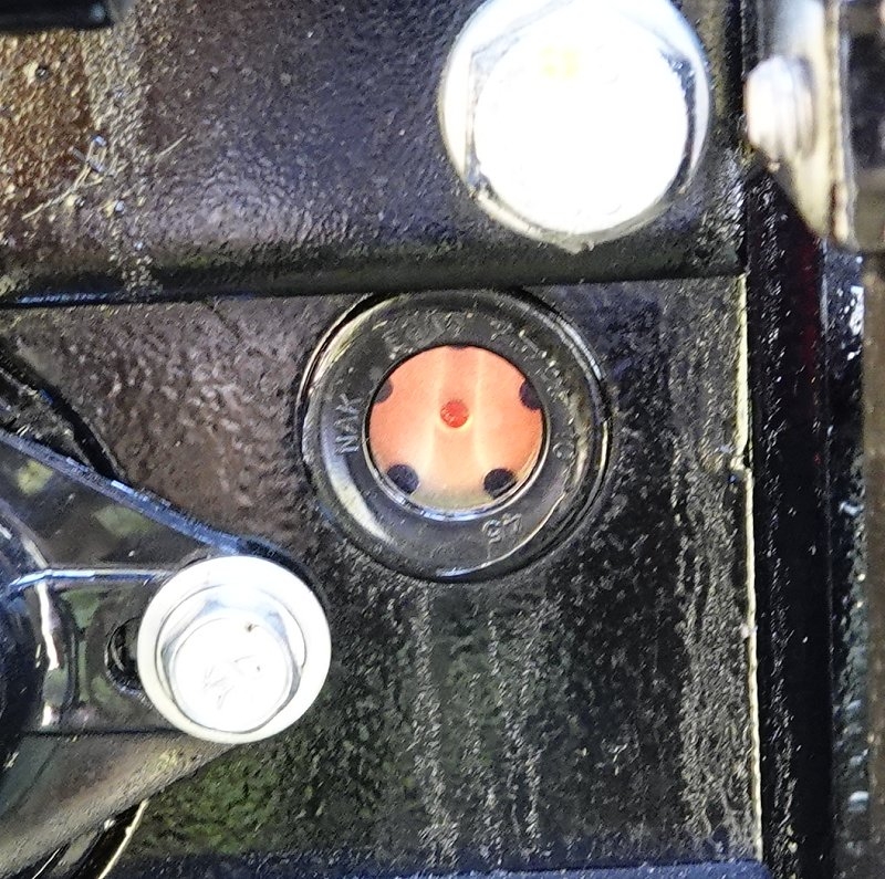

Rich, you seem to be making mountains out of mole hills.
What you have is a slightly overfilled hydraulic reservoir. It has been mentioned previously, but looks like you asked again about how to check this. You need to lower your three point hitch and front end loader to check. This is really to remove all pressure from the hydraulic lines, so do this while the tractor is turned off. Move that loader lever around to remove the hydraulic pressure. Should be no pressure in the hydraulic lines.
You can also add more dye to get a more pronounced red color. It doesn’t look like it has fully mixed together the dye and oil yet, so it will likely darken some. I like mine more red than not so I can easily check. That dye will not stain the glass or metal in your system so don’t worry about that.

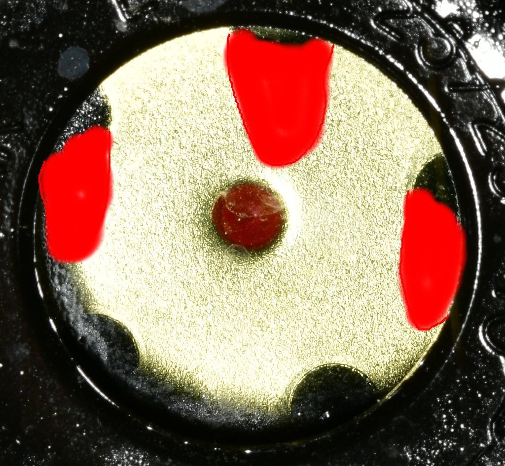

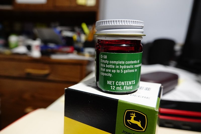

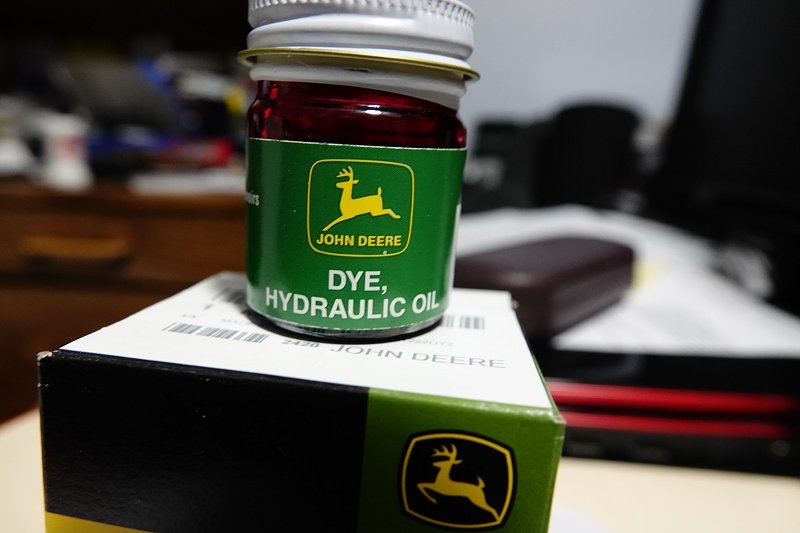

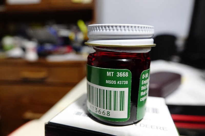

Man, I don't know what to think. I added the bottle of hydraulic fluid dye I had. Surprisingly it was more of a red/maroon color. I expected it to be green. Anyway, I added in the whole bottle, then drove the tractor around a bit to mix it in with the hydraulic fluid. It took a while before I saw any change, and when I did, it wasn't what I was expecting at all. What I saw through the sight glass was the colored fluid dripping down from the three holes at the top of that metal piece showing there. I had expected I was either going to see no change meaning the fluid level was not high enough to show in the window, or that the entire window would show the newly changed colored fluid, with the fluid being overfilled covering the entire window. So of course I didn't have my camera handy.
I drew in an approximation of what I saw in the window as best I could.
The color wasn't that brilliant, of course, and I am no artist, but the effect is pretty much what I saw. If the sight glass were filled with hydraulic fluid, how could this sort of effect be produced? The dyed hydraulic fluid wouldn't be thicker nor heavier than the undyed fluid, so how could this visual effect take place.
I did go to the house and get my camera, but by the time I got back, the visual effect had changed quite a bit.
The dyed fluid has dripped down that metal face, and you can still see the gold color still visible as narrow vertical streaks between that dyed fluid that seem to have dripped down over the face of the metal. Wouldn't the dye have pretty much been distributed uniformly all through the hydraulic fluid instead of dripping through those holes?
Of course, now I am wondering if that metal piece visible through the sight window has been permanently stained from the dye.

As to how that effect could happen...the oil that was adjacent to the glass will not mix as readily as the oil that is further in the system. Put some food coloring in a batch of cookie dough in a mixer. Watch how the color spreads. Certain spots just take longer due to adhesion.
I agree with above. Relax and enjoy your tractor.

Try to relax, and just go forth and enjoy your new tractor. Nothing bad is going to happen here. You are likely a little bit over full. This will not harm anything. You are obviously above the sight glass with hydraulic fluid, which is what we all kind of expected. You don't need to add anymore dye, as the portion you just added has done it's job. It has "proven" to you (us) that it is full.
You certainly don't need to try to drain any out. You are fine. Now go get some work done, and post some pictures of your tractor at work.
