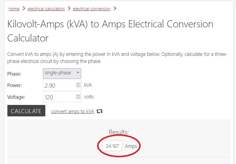

A little bit you can learn from welders owners manual, why you keep popping your 15 amp breaker....
From Hobart Handler 140 manual...
And A little internet electrical conversion...
