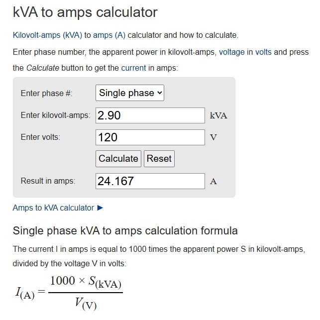

Had the breaker tripping problem with my Hobart Handler 140.... Come to find out, it draws 24.167 amps (2.90 kVA) when running flat out.... Solution was to run a 10 gauge wire from 30 amp breaker to a dedicated 120 volt type receptacle ... And yes its legal if receptacle is labeled for welder use only per NEC......
