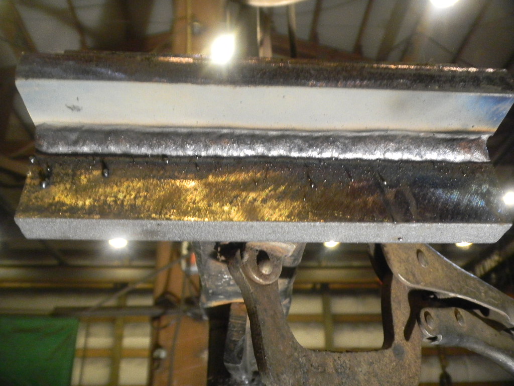

I have some dual shield wire I cannot keep from worm tracking. I need to re-bake it, but I don't run enough dual shield wire to worry about it now. If I ever need it I'll stick it in the oven. Remember what ever Lincoln suggest for stickout, that is what I would do. The wrong stickout will give you worm tracks too. Correct stickout is crucial with some wires more so than others.;)

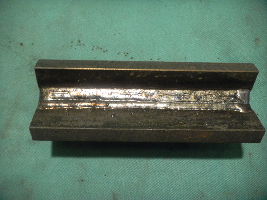

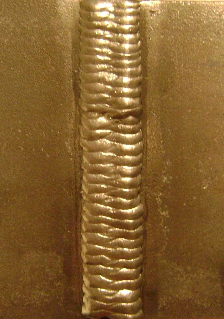

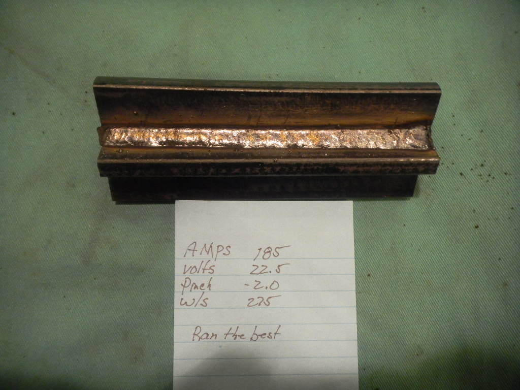

I had a bottle of C/10 a while back to play with some spray arc welding. Didn't think to try it with the 70 Ultra Plus. I have some ESAB 710X that I have no problems with C/25.
Some over head, vertical up, and flat fillet.
