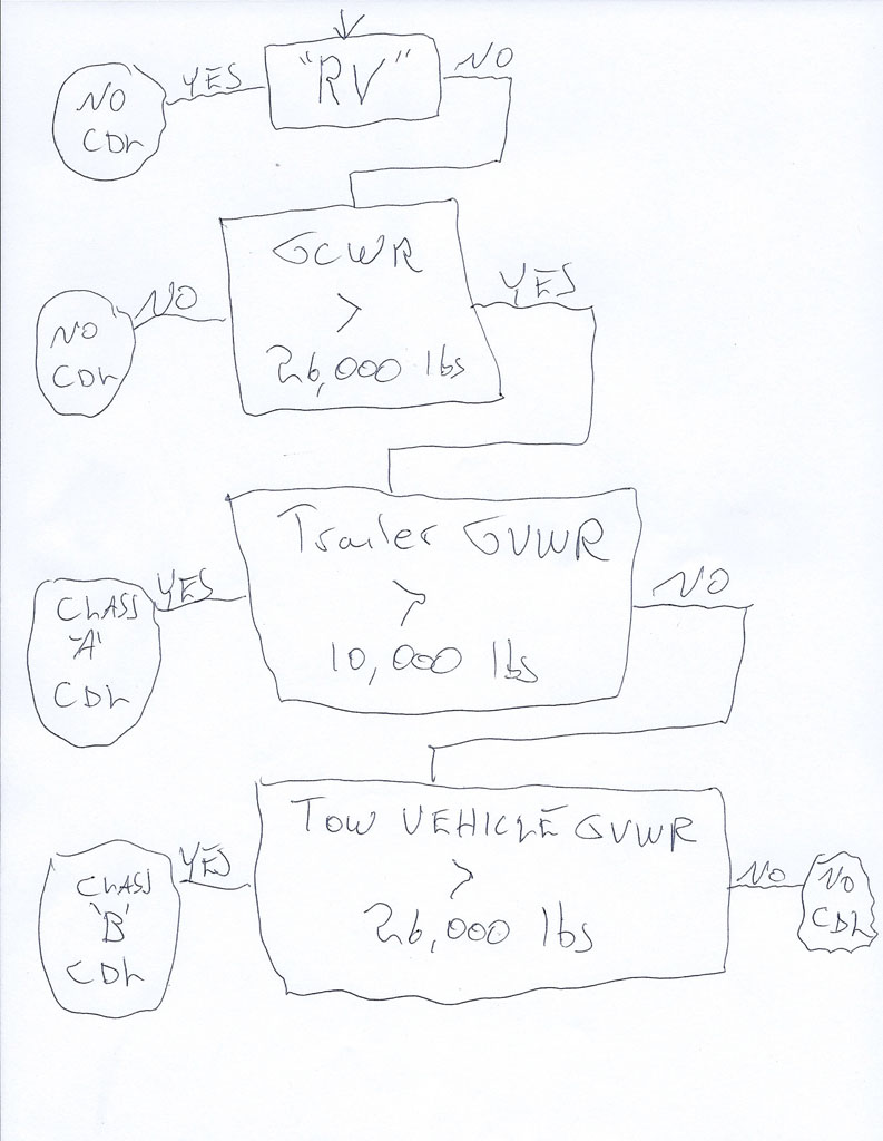

   / FMCSA interpretation of GCWR #4
So... does this about cover it?
(Did not include class c logic -- which is where the last "no cdl" at the bottom right should lead to... with no passenger busses or hasmat vehicles in the picture, this should be accuate I think)
Start at the top and work your way down:

I wan't going to get into states and their rules since they can deviate from the federal. There are certains waivers allowed that the states may choose to implement (farmers for example). They can also implement more stringent rules. They cannot "ease" the rules with the exception of special cases. The farmer being one.
By the way, in my searching I found this: http://www.dol.wa.gov/driverslicense/cdlvehicles.html It is a much better diagram that what I made! Since it did come off of Washington's website, it "could" have some Washington specifics there... but it appears to be the basic federal rules in the diagram.
