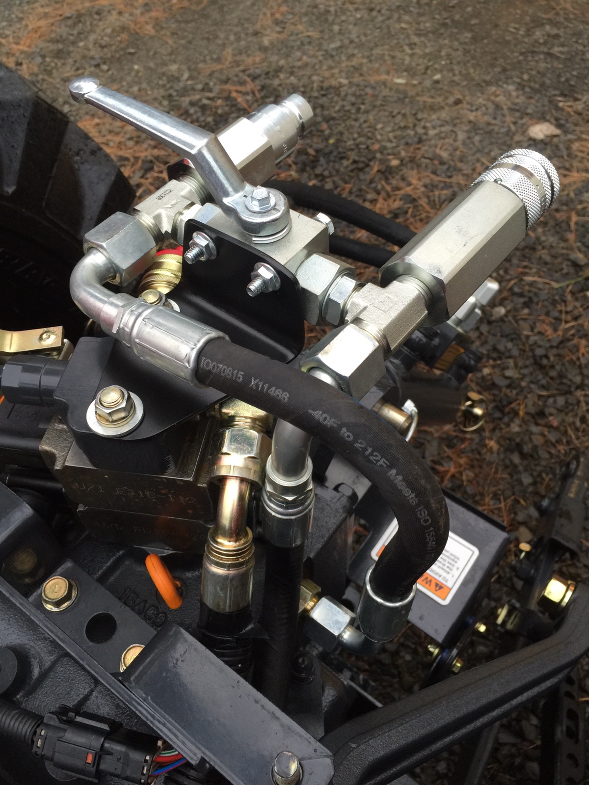

Hi there,
-I'm sure this had been beaten to death many many times but I want to vent.
I have a 2018 Massey Ferguson GC1720. If I had paid closer attention before purchasing it to the way that the linkages need to carefully fold away when not in use and how the hydraulic hoses need to be run somehow to not get kinked or split when the backhoe is installed or 3pt arms are moving, I might have considered other makes.
I am always worried about how my lift arms move down while I adjust the MMM height while mowing since I cannot move one without the other. Sometimes I don't have anywhere to store the backhoe so I need to mow with my 1720 fully kitted.
There are 3 hydraulic hoses that have about 2ft or so in length that hang off the back of the tractor.
When the backhoe is not in use, one hose needs to be connected to another to complete a circuit, and another capped-then they just sort of hang there, which we can't have.
THEN, you have to find what to do with them. I cannot loop them around the top mount and tuck them under the fenders or anything since that would be too tight of a loop. I have to sling a bungee cord to my ROPS or somewhere and wrap them, suspending the hoses in such a way that they are clear of the 3pt moving parts. Even so, I am incredibly worried that I will damage them accidentally through normal use of my tractor.
Growing up, the few tractors I had been around had couplers mounted on the rear and the implements generally provided the line to them. I just assumed this was normal.
**** Anyone have any ideas or examples on how others have addressed this? ****

I am curious if I could mount my own bracket and put QCs on it to make it so no hoses need to remain hanging from the rear of the tractor. The rear circuit that needs plugged into the other to complete the loop could be addressed with a shorter, custom line with 2 male ends that I could store onboard in a toolbox. I think is how it should have been designed.

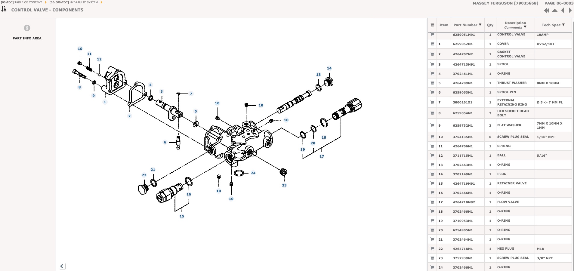

At least you have rear hydraulics... My 1715 does not and I cant find out how the hydraulics for backhoe (power beyond) are plumbed....

I'm going to guess it has to do with the plugs shown on the control valve. I will confirm if there is another manifold of some kind or what. I think there is also a plug shown on the transmission that is used on mine.

I had that issue and decided to fix the problem by redoing the connections at the rear. Works out exactly perfect, no loose hoses at all. If you had the backhoe physically mounted but don’t need to hook it up, you could literally reach back from the seat and turn the ball valve. With my setup, I use the handle as a “key” to prevent accidentally bumping into it and it’s stored on the key rack in the shop.
It was my guess to....... But sure would like documentation to prove it.....I don't have a issue of tearing into tractor to add the "power beyond" IF I HAVE GOOD INFORMATION....

Dale, you will need the Hose Kit found here: Access Page Click on Guest Login and then follow my link. Hose Kit From the CB65 parts book.
   / Folded Lift Linkaged Scraped Backhoe Subframe #12
Dale, you will need the Hose Kit found here: Login From the CB65 parts book.
OK... Thanks. Will have to find another way in as your link does not actually get me to a login. screen ...
UPdate:
Login
Next issue is what ports... Seems like the 2 short (650mm - 25 inch) come off pressure regulator (3PH) control valve assembly... Long one (1300mm- 51 inch) is enough to go to FEL control block.. WAG here....
Kind of get feeling that a hose from 3PH control block/pressure regulator to FEL port (P) is removed and "P" (from control block) is to BH (P) and "PB" from backhoe may go to FEL control block (P) ... OF course with no backhoe, a "loop" is required (quick connects just looped (male to female?))...
