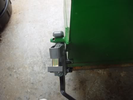

Had a chance to play with Pat's 3pt quick hitch on the JD X585.
First let me say that Pat's is nicely made unit. It fit on the lift arms just fine but the Xseries lift arms have a peculiar turn up at the ends. Here are some pictures that show without and with Pat's. Notice that the turn of the lift arms causes Pat's to angle up and interfere with the ballast box. If JD needed to raise the pivot point of the arms, they should have made the elevation change in the middle of the lift arm. So now I have a Pat's Easy Change that I can't use /forums/images/graemlins/frown.gif

True that I could move the pins on the ballast box and also can make it work if the ballast box is up on wood. In fact I slap some casters on a peice of ply and now can move the heavy box out the way /forums/images/graemlins/cool.gif But what about future implements /forums/images/graemlins/confused.gif
The problem is when lifting the ballast box up, the angle causes Pat's to hang where the U bolt mounts. Picture shows this is in the lowest positon. As you raise it up it binds.

hmmmm,
did you check this binding with the toplink in it's shortest position? tilting the box toward the tractor? if that works, maybe you could weld a piece of angle iron to the bottom and change the angle as it's sitting to help install and remove?
