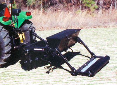

I'm attaching a pic of the implement I'm looking at.

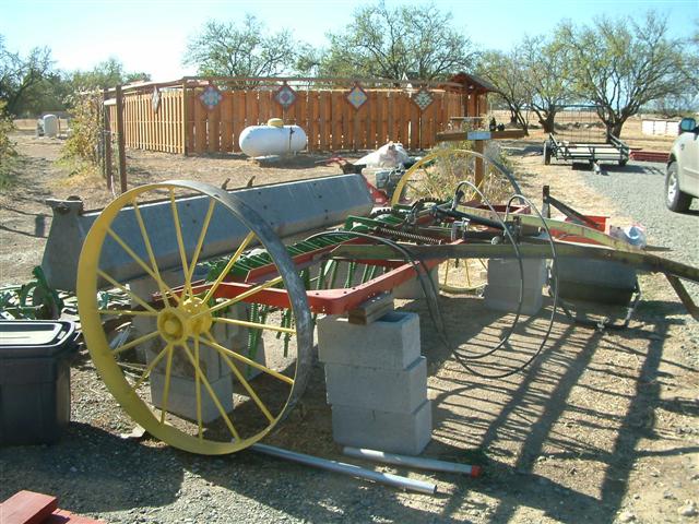

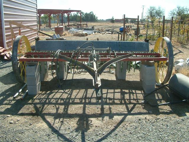

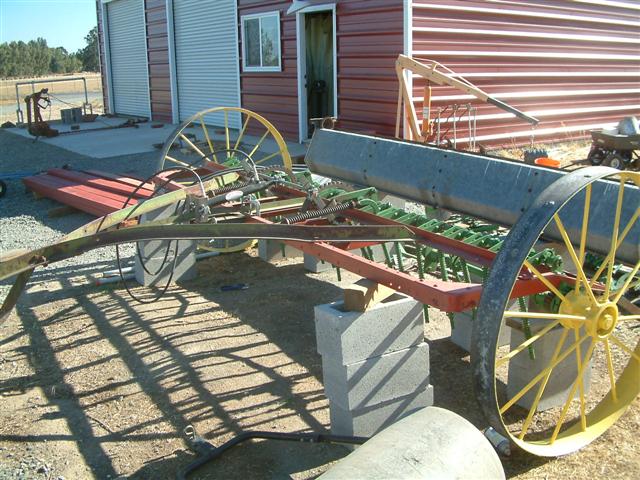

I restored an old Minneapolis Moline P3-6 grain drill (10 ft wide, 20 hoes, single disc openers) and added a hydraulic cylinder to raise and lower the openers. Bought a pair of these for $275 and used parts from each to make one good drill.
It works fine in prepared soil (disc and drag) but the frame structure on that drill looks to me to be too lightweight and flimsy to handle no-till applications. The no-till drills I've seen are much more massive and heavily built with much stronger hydraulics. Some of the more modern grain drills are more heavily built and might work better as no-tills. I see these all the time on eBay in the $500-1500 range. Don't recall ever seeing one sell for $100.

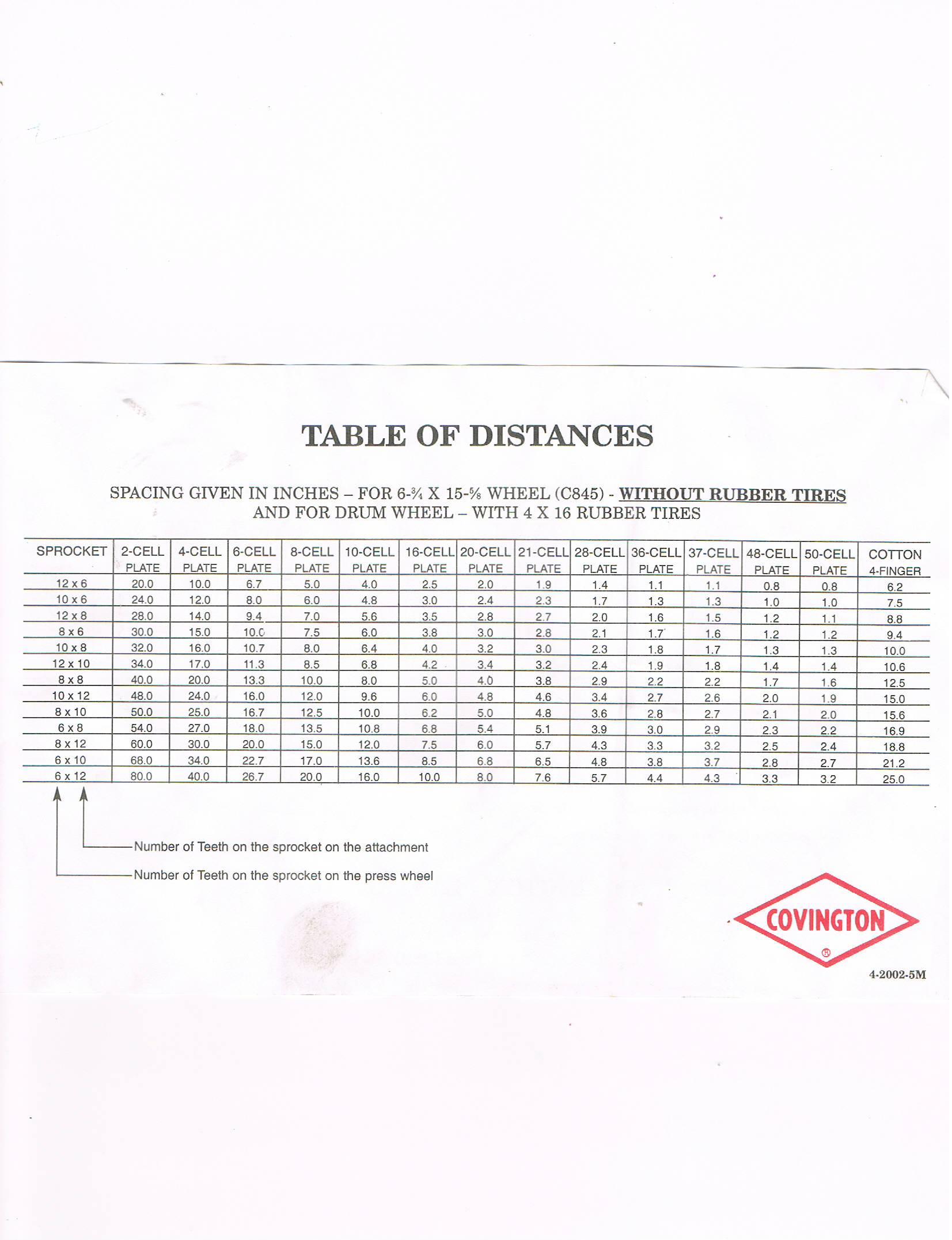

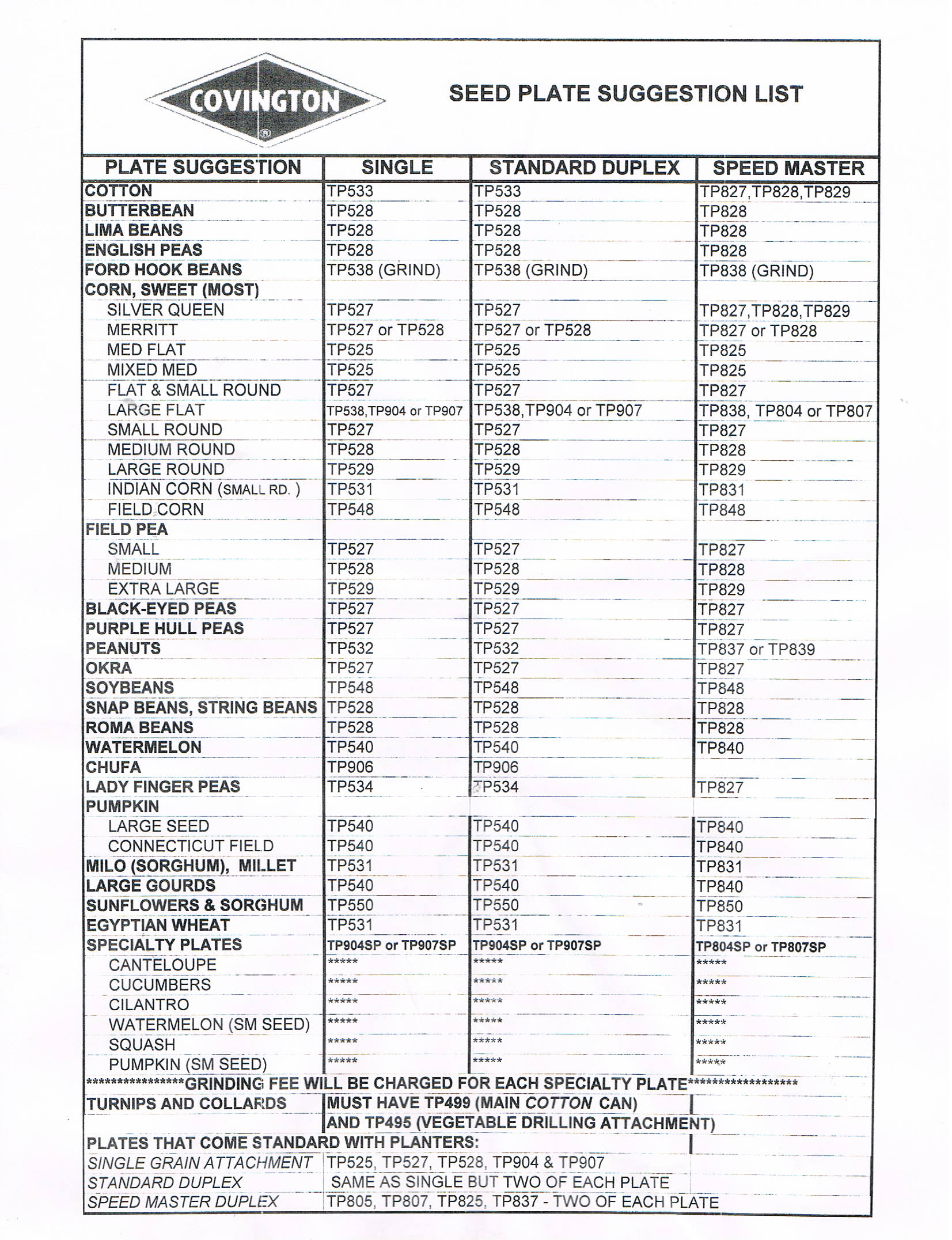

This planter/cultivator by Covington is one of our top sellers for foodplots. $1395 + shipping. It comes with 4 plates and has dozens of additional plates available. Made in the USA. Ken Sweet
