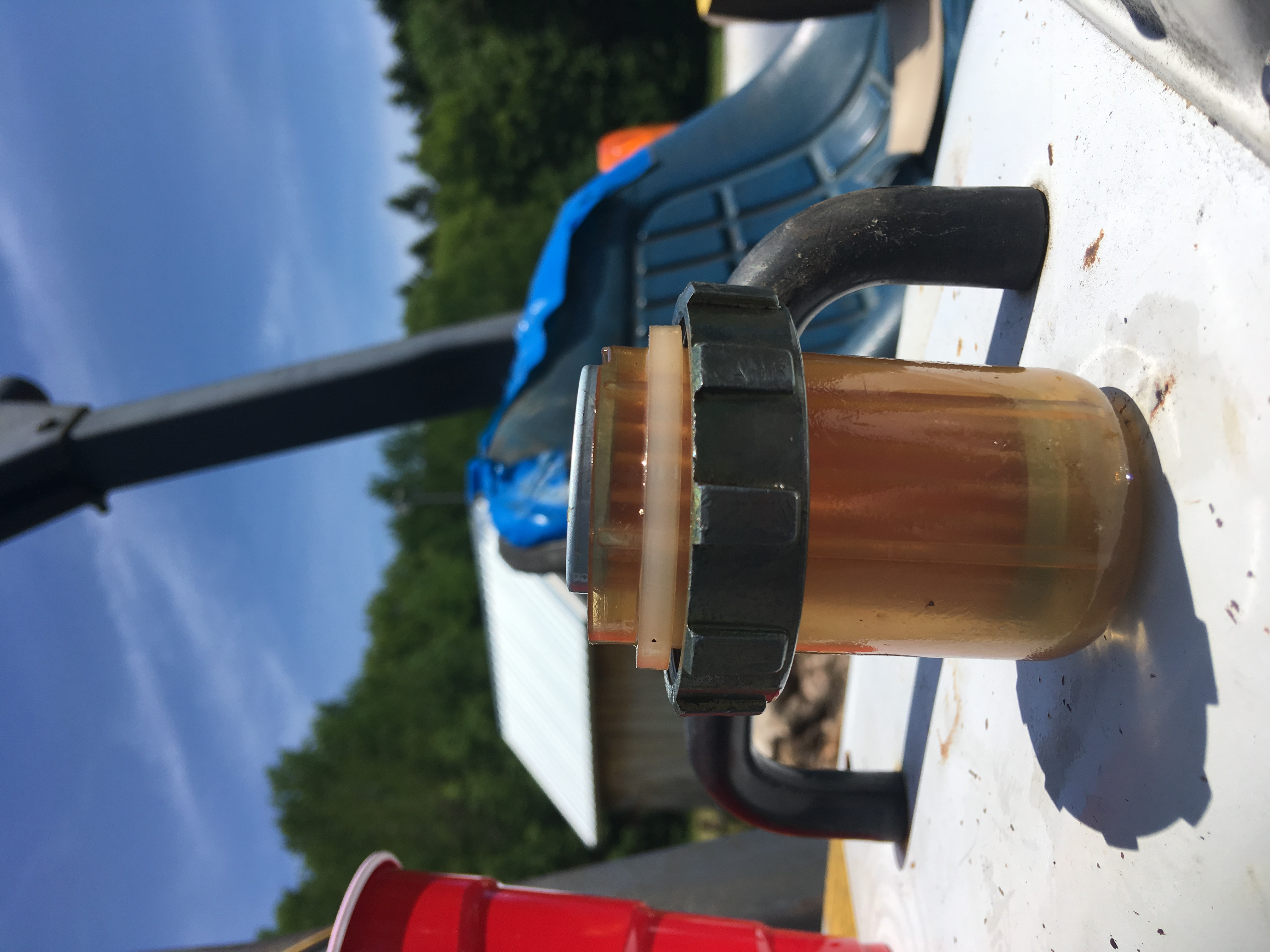

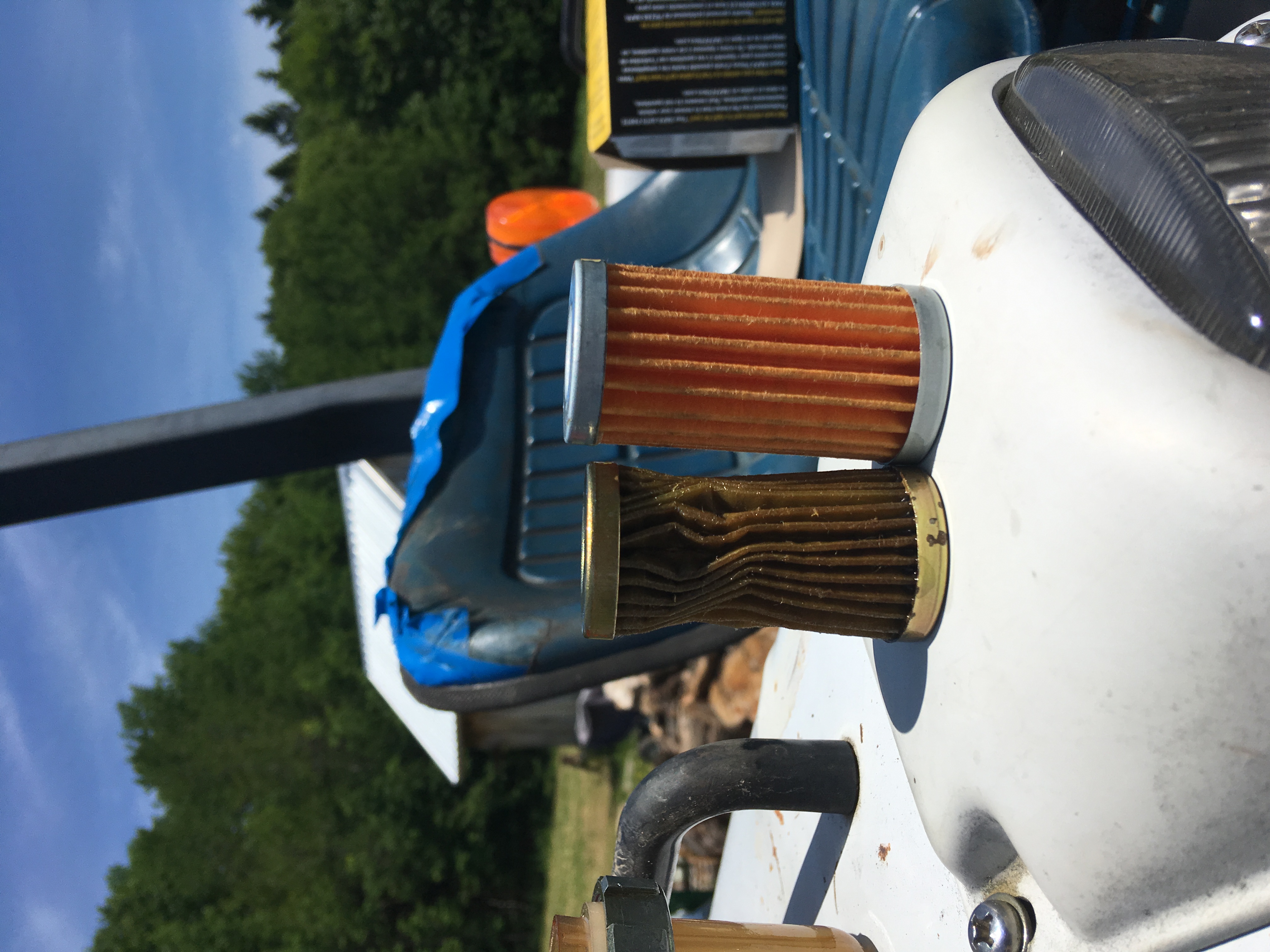

Been putting this off for too long. The fuel filter for my 1510 is slightly too long for the bowl, just enough that I can't get the threads to engage. I can tell the filter that is currently on there had the same problem, but the previous owner just pushed 'er on anyway. The old filter is made in Japan so I am wondering if my fuel bowl is aftermarket and too short? I bought a filter from Messicks and now from Napa, which are identical.
There is a small 'platform' at the bottom of the bowl that I guess I could file down about 1/8" to get the filter to fit.
Hoping someone can offer some advice here. Thanks
Pics for comparison

I see you have it figured out.
Others have struggled when the steel top end of a filter cartridge stays up on the nipple in the filter head. When that happens there is insufficient room for the cartridge.
