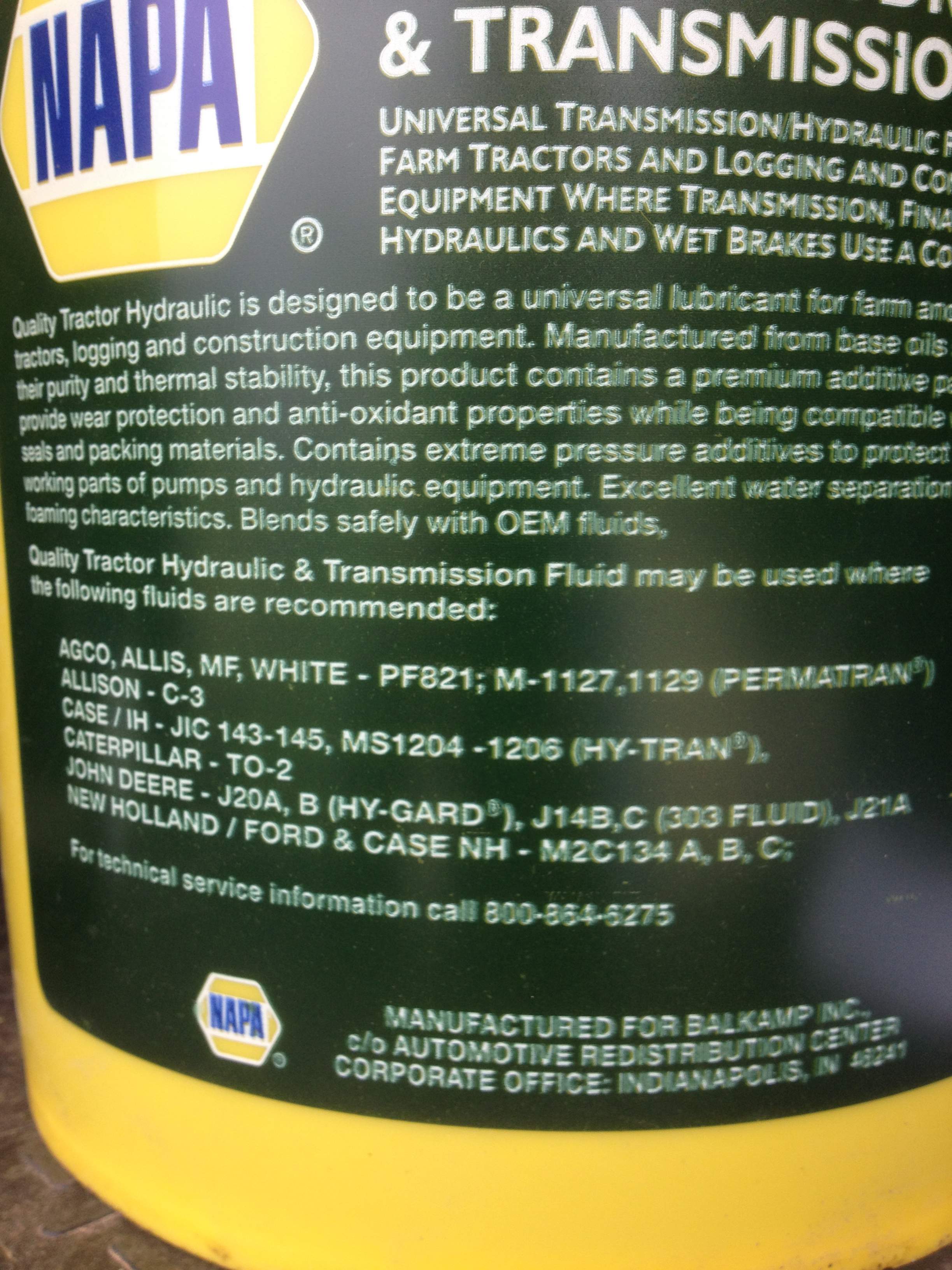

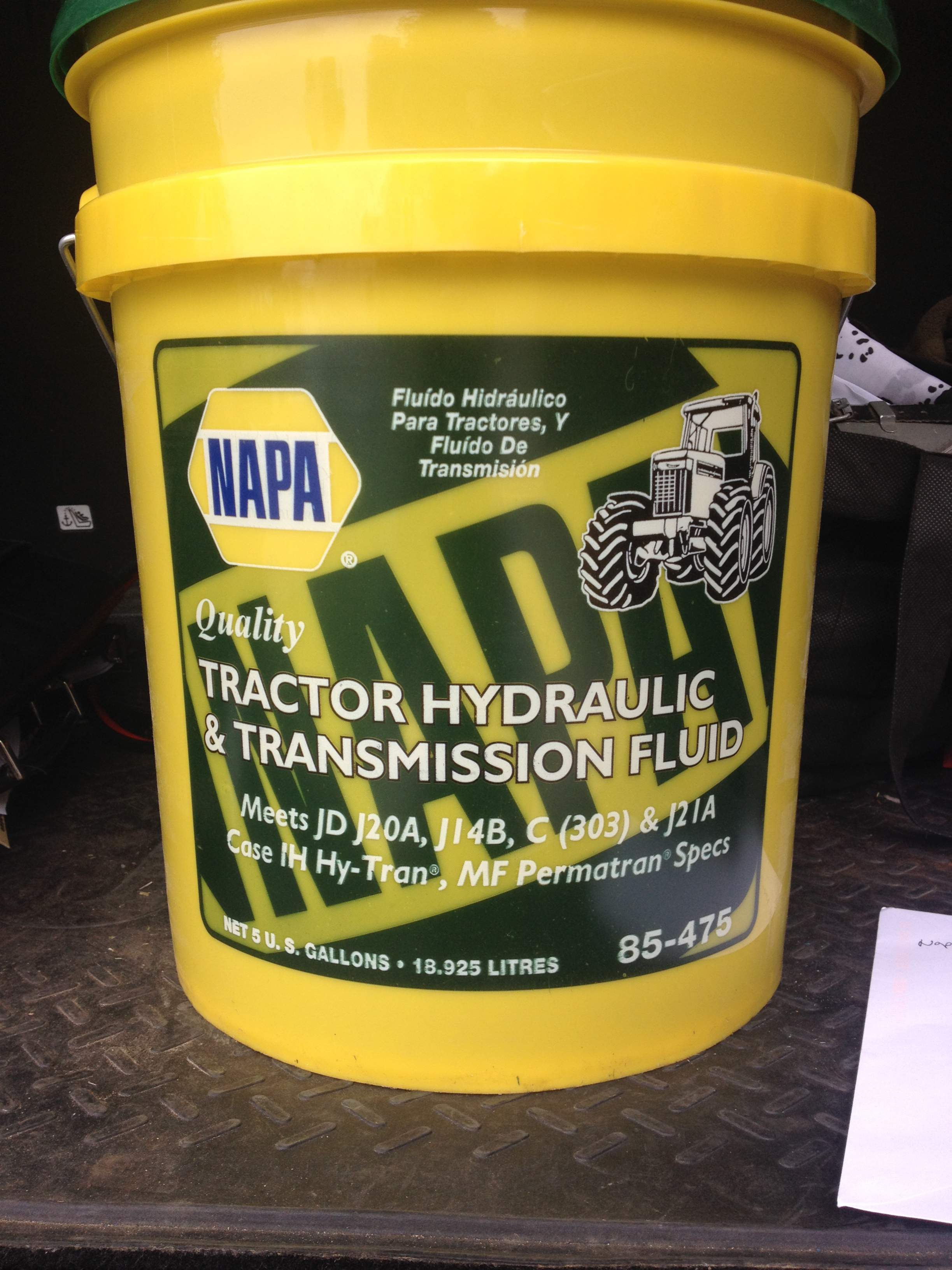

I have to replace a hydraulic line on my 1510 and thought that I would change the fluid while I am at it. I found tractor hydraulic & transmission fluid at NAPA that is rated for New Holland/ford M2C 134 A, B, C. I know that it uses Ford 134 rated fluid. Will this work? It is NAPA 85-475

Yes, that fluid will work fine
Thanks for confirming it for me. I am actually planning to change it tomorrow so your timing is great. I feel a lot better using it now. Gary
