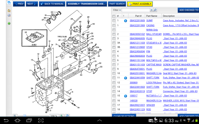

I have a 1510 that I believe has a bad neutral safety switch. I'm looking for a recommendation on how to best access this switch since it appears to be inside the transmission housing.
Thanks in advance
   / Ford 1510 neutral safety switch #2

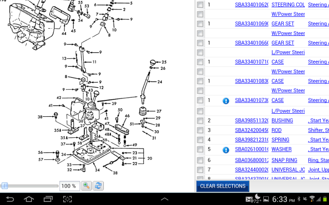

On both transmissions, the shift cover must be removed to access the switch under it. ForumRunner_20151123_202222.png
On the synchro column shift, the range shift cover #42 and column shift shaft must be removed before the shift cover can be removed.
