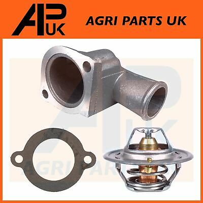

I need a new thermostat housing for my 1984 Ford 1510, but am having trouble finding a replacement. Even online searches haven't been much help. Is anyone aware of a workaround for this? Maybe a different housing that will work or some sort of convertor? Thanks.

If it a regular size thermostat with two bolts horizontally opposed, get a generic at auto parts. Go to a junk yard and get one off a foreign ride. Lots of options. If the holes arent quite right, round file time.

I'm not sure what his 1510 looks like for a housing. If it's like this, then yes other housings would work too. Just have to match the bolt hole pattern.
this is for a Ford 5000 as an example.

Thank you everyone for the suggestions. Some of the replacement parts look similar to mine except the bolt holes are rotated and are located at 5 and 11 o clock. My next action is to check with auto parts stores and then I'll contact the other parts stores that you have mentioned. Thanks again.

Looks like vehicles from the 70s and early 80s would be a a help.
These Japan tractors really didn't have too much customized. For Yanmar, lots of the Datsun (now Nissan) parts of that era work.
Likewise for the Mitsubishi tractors from back then, the Mitsubishi truck and Mazda truck parts fit.
