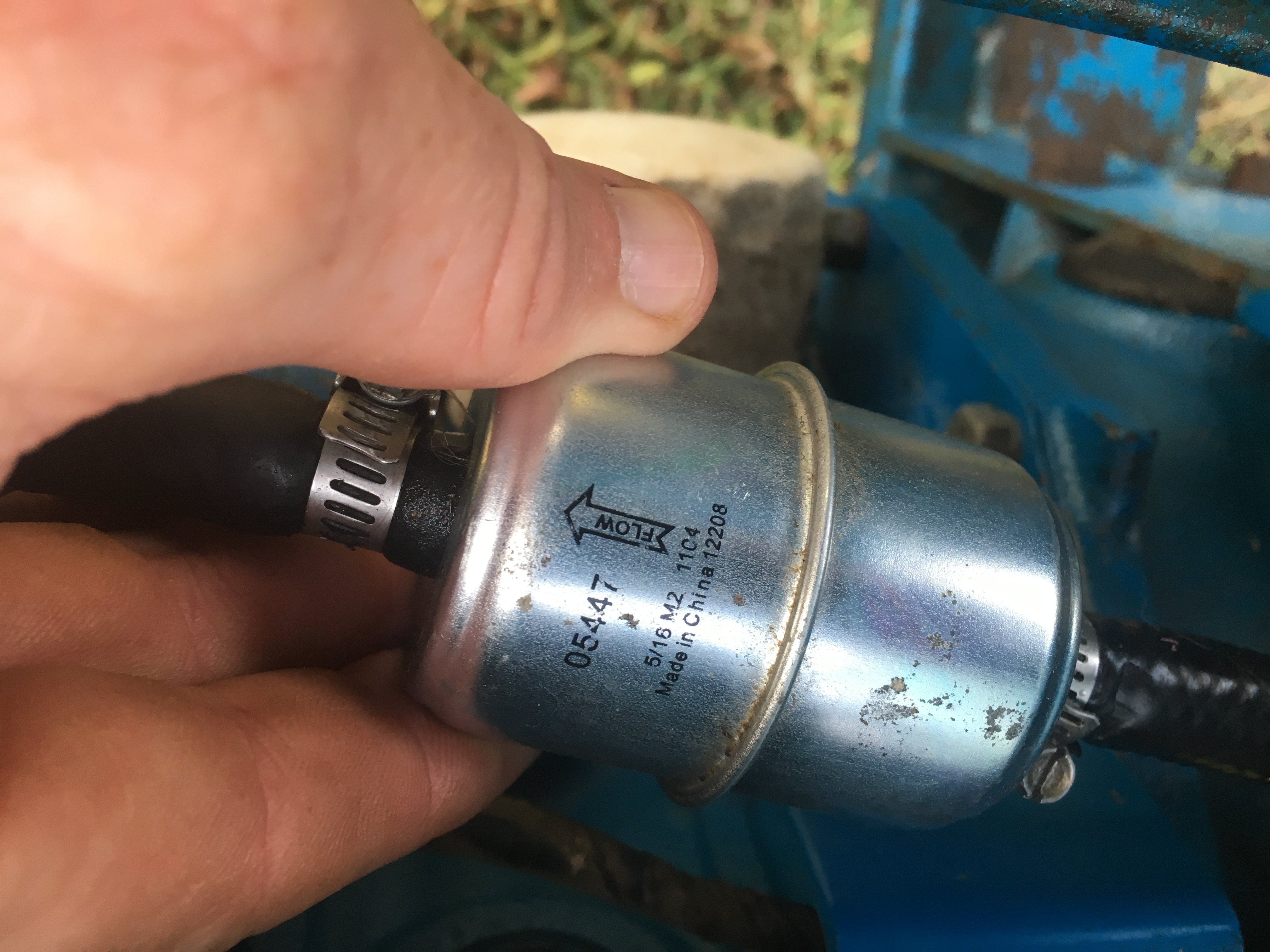

So this is the inline fuel filter that is on my tractor. As I said above it is not the one in the manual that has a water trap and fuel filter assembly. Is this the correct fuel filter or a workable one that I can replace with the same and expect good results? Or do I need to get the full fuel filter assembly with water trap?

   / Ford 1510 Will not stay running #8
That is just a "filter" for dirt.. it wont trap water..
With an original set-up, you can "see" the water being trapped thru the bowl.. with the one u have now, you cant..
& the water is what kills most of these small engines.
They also make a clear version of that filter.. I don't know the P# tho..
They're only about 2.00{LOL} so change it..
   / Ford 1510 Will not stay running #9
you should get a good diesel fuel filter with a water trap, it's worth it.. what's on there is a gasoline filter..
   / Ford 1510 Will not stay running #10
The clear one is WIX P# 33971 BUT shouldn't "take the place" of a decent water separator..
Used in conjunction w/ the original set-up, the 33971 would be beneficial.. on any machine..
