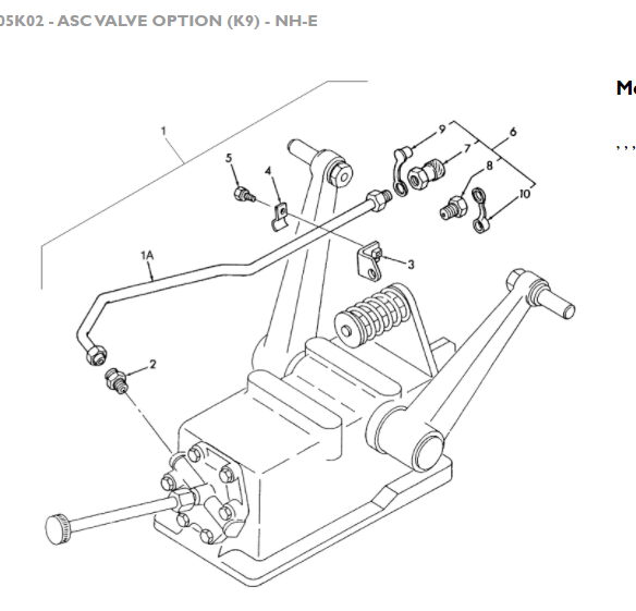

Anybody know what the ACS valve option is. I'll post diagram. Any help is greatly appreciated.
from the parts manual.

Don't know the nomenclature for ACS (Maybe auxiliary control spool?) but looking at the diagram, it's just a single actually remote on the back. Useful for dump trailers, hydraulic lift on the pull type brush mowers, etc. Basically things that need pressure to go up and gravity will pull it back down.
   / Ford 1520 ACS valve option what is it? #3
Ditto what ptsg stated.
