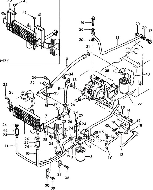

I've got a good friend with an 87? Ford 1520. 3 times in the last 2 weeks he has blown the gasket rubber out of the hydraulic filter, and the filter has been replaced twice. I'm a 30+ yr mechanic and I'm betting there is some kind of restriction or stuck bypass but I have not gotten a manual yet (ordered) and I haven't gotten up to his house yet to look. I am hoping this is something someone here has seen before and can save me alot of work? Any ideas would be appreciated.

Used to be a significant problem often traced to New Holland's never-ending shuffle of filter suppliers and part numbers. The current SBA340501030 hydrostatic filter has not suffered seal failures in my experience. The factory measure of charge pressure probably will not indicate a problem. Properly install the correct, current New Holand filter if your friend is currently using ANYTHING else.

These tractors have a suction filter and an HST pressurized filter. My bet is that the problem is the pressurized HST filter and the problem can be resolved by RickB's method. NH has had a rash of blown HST filter seals, especially in winter when charge pressures are initially highest until warmup.

Thanks Rick, but now it's really panic time! We put the new OEM filter on and blew the O-ring out of it twice.Can you steer me in the right direction for an order of testing or diagnosis? Any help would be greatly appreciated!

Now that I've been beaten up for multiposting ( deserved) and for not having my story straight ( undeserved) I will try to contribute to this as I diagnose and repair this. All this expert opinion about failed filters has me looking at it differently. Why did the original ( wix btw) last years and now it won't stay on? I will post pics when done. I removed the housing from the tractor. On inspection it looks like the oring makes contact outside the polished surface and seats partially on the paint and rust. Unfortunately I disposed of original filter but I suspect with all the filter upgrades and changes they may have gone to a larger diameter seal. I also spotted that I could tighten it until the metal cannister lip made contact. I machined a small amount off the outside circumference to allow it to clear so I might tighten the filter a little more. Should the filter not be the problem I drilled and tapped the housing to accept a gauge to check line pressure. Should there be a problem with the HST we will not spend the money to replace it, I will put a bypass valve in my tapped hole and vent a little pressure back to the tank. I will post pics as I go

The correct filter for your tractor is:
FILTER
Filter, Oil, HST, Start Year: 01/01/1987
SBA340501030
1 Needed for Job
$26.91 In Stock : 30
Below is a diagram of the hydraulic and HST piping.

my two cents and I can be wrong. I have a tc34da and this is from the manual. HST different but probably not that much.
The charge pump on the HST takes suction oil after the hyd filter.
The charge pump relief valve is set at 61-81 psi. or maybe 75-95. Numbers are different in different places. Flow is to the cooler and then to the HST filter and then to the HST center section.
So the HST filter should never see more than 95 psi. If the filter is not seated right 95 psi could do it. The bypass over the charge pump relief valve is back through the cooler.
