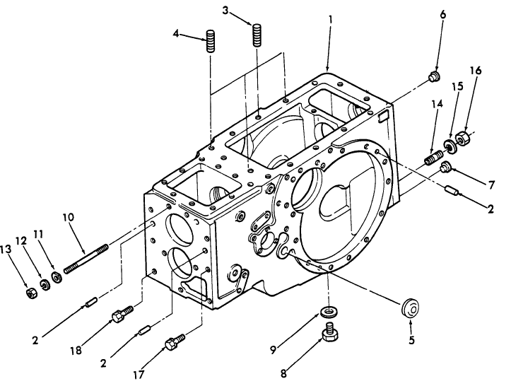

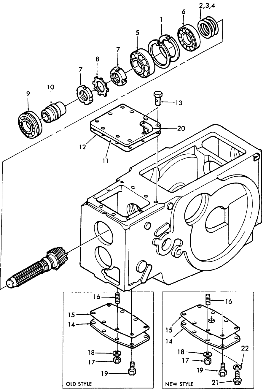

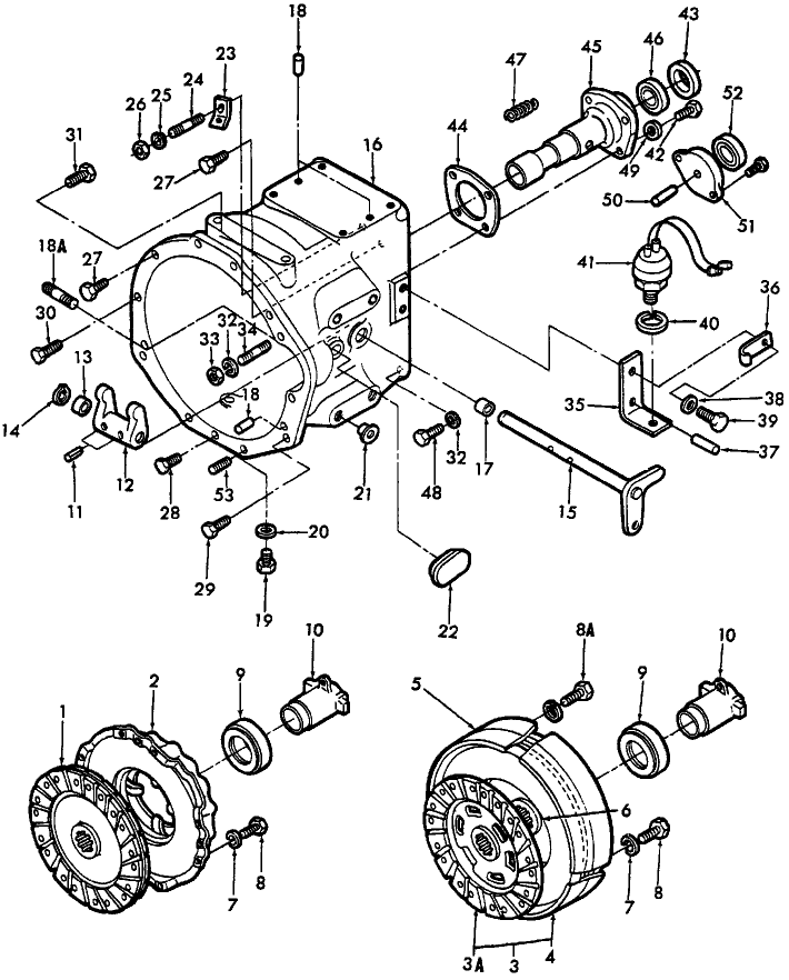

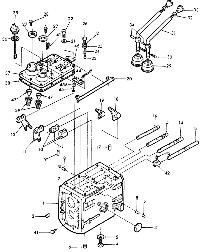

Sorry to hear that piper, could be an expensive repair. Some pictures of your progress would be great, the more info the better. Makes me want to pull my 1700 apart and inspect those parts. Good luck, TB
/ Ford 1700 just stopped moving #13
Here's a few pictures from the parts manual if it helps...TB
