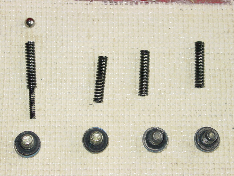

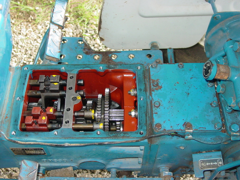

Those are the pics I shared many moons ago on my 1700. On mine clutch safety is external. Detent balls are larger the hole from top hence you cannot pick them up by magnets. you will need to take the cover off. If you are careful you can take it off without damaging the gasket below. Pics below are self explanatory.

I'm hoping the spring I dropped is able to fish out with a pick up magnet. If I can't get it out and it is in there, will it muck up a gear?
It could "muck up" a gear, but most likely would get in a bearing and muck it up.
