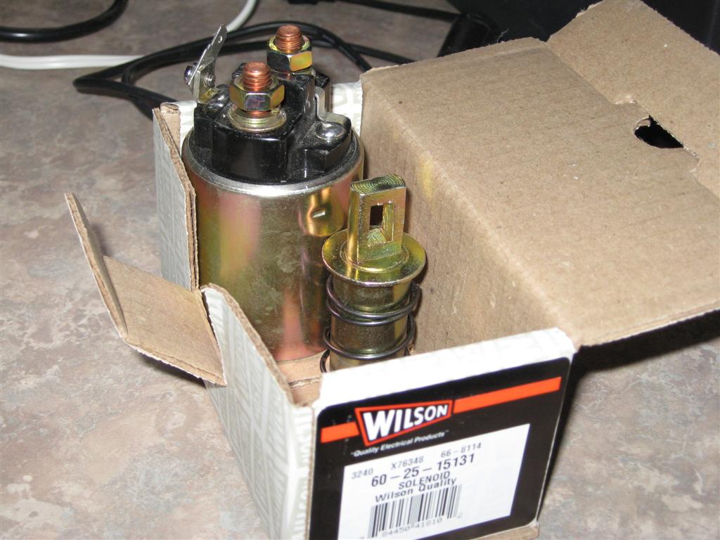

   / Ford 1700 starter parts #2
I'd suggest heading back to NAPA and asking them to dig out their Wilson book. This is what the local NAPA came up with for me. It ended up being a special order item, but only came to something like $35 with shipping.
-Neil
Thank you for the response. From reading your posts here I got the impression that was a replacement solenoid for the Hitachi OEM starter. Is that correct? I have an unknown brand that's not Hitachi (the starter shop guy thought it "looks kind of like a Lucas") for which they believed they couldn't source rebuild parts. Do you know if the solenoids match?

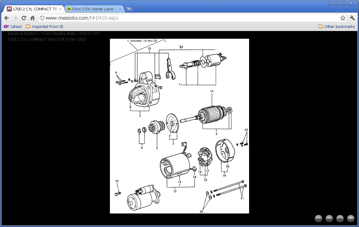

   / Ford 1700 starter parts #7
Messicks.com shows the solenoid (electro-magnet part # 11 below) to be available for $304. That ain't cheap, but it's a whole lot better than $1100.
ELECTROMAGNET
Solenoid, Start Year: 01/01/1979
SBA185816070
