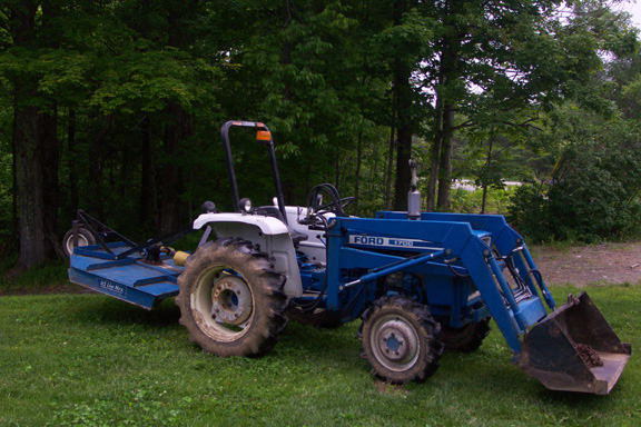

Here's a few photos of my '79 - let me run down back and look at my accessories, and I'll tell you what I have - maybe it's no big deal. Mahindra has the old IH 4xx series design from the 70's, and the IH guys I've read on other forums seem happy to get quality Mahindra parts at 50% less than IH replacements for their old IH's.
Here's the "first day home" shot. $6500 with bush hog, delivered by a friendly coworker who also happened to be a truck mechanic that works on boom trucks, so he has extensive experience with hydraulics, and diesel stuff. "Someone" /w3tcompact/icons/eyes.gif seems to be looking out for me. It's a dirty job, but someone's gotta do it.

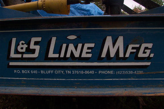

Good morning Mark...
I can't read the writing on the rotary cutter... but is that a Ford labeled unit...?
KingKutter has OEM'd them for Ford in the past... and that's what that one looks like... /w3tcompact/icons/smile.gif

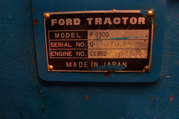

Here's my tag - the engine number is LE892-35704. That is also on the engine block below the starter on the left - cast in about 1/2" high letters. The numbers start with M732, then below that, LE892 - 1272cc, then below that, on a small cast boss, stamped in about 1/4" letters, 35704, which is probably the engine serial number.
As you can see, my serial plate says Ford, then Model F-1700, then Serial #U-701034. I could not find that number anywhere on the tractor as a casting. I think Ford applied it once it got here. I think the tractor was built for Ford overseas.
I looked around the tractor, and found the following:
Alternator: Hitachi - no other markings visible except the Field, Ground, and Positive markings.
Starter: Hitachi - lots of serial numbers and model numbers - hard to read - I'll ink them if you need them.
Injector Pump: Diesel "kiki" Assembly # 4302-419. Then NP-PES2K70C210RS2N2. There's also a stamped number, proabably a serial number, which I can ink if you want to go farther with this.
Castings (all about 1/2" high):
Under serial plate: "S" (with a circle around it), and M330 1
Below PTO lever on left, ahead of Differential assembly: 78 10 17, then below that, "S" (circled) and M340
On Hydraulic casting, on left (under seat): M100-3, then below that, 225
On Differential area (Bull gear housing? Brake linkage goes in there) on right: 79 02 07 (also on left, down underneath)
On bellhousing section between engine and trans on right side: 111, then below that, 54-126, then below that, M090-2
I wouldn't be afraid of the tractor itself. I'd temper that with the "story" and the dealer - his attitude, shop appearance, etc. I'd be interested in learning more about that tractor, if you pursue it, just to learn the similarities/differences with the Ford.

Hi, John
The cutter is "L&S Line". The original owner has a PHD from them, too. He found a dealer here in Maine, and liked the overall quality, and the fact that they were blue - don't know about color selection, but I plan on calling to get a manual, if available. I'd appreciate a critique, as I have not heard of them. It's a shear pin unit, not a slip clutch (if that's the right term). I spent time photgraphing it because I firgured I'd be talking about it soon - been busy working on shift, and residing/replacing windows in this great weather, so not using the tractor lately. I spent 6 hours one day cutting grass and brush (2" poplar) a couple weeks ago - it worked great, but I got whacked in the back of the seat by something once, so I'm wondering about guards. A friend with a 3010 Kubota and lots of experience 'hogging and tilling told me to plan my work so I was cutting with the long stuff on the left, because the hog throws right - what a great suggestion (Thanks, Dana, if you're lurking)- the grass was chopped and dispersed well.
I'll follow this with a couple other pictures.
