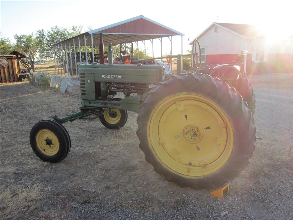

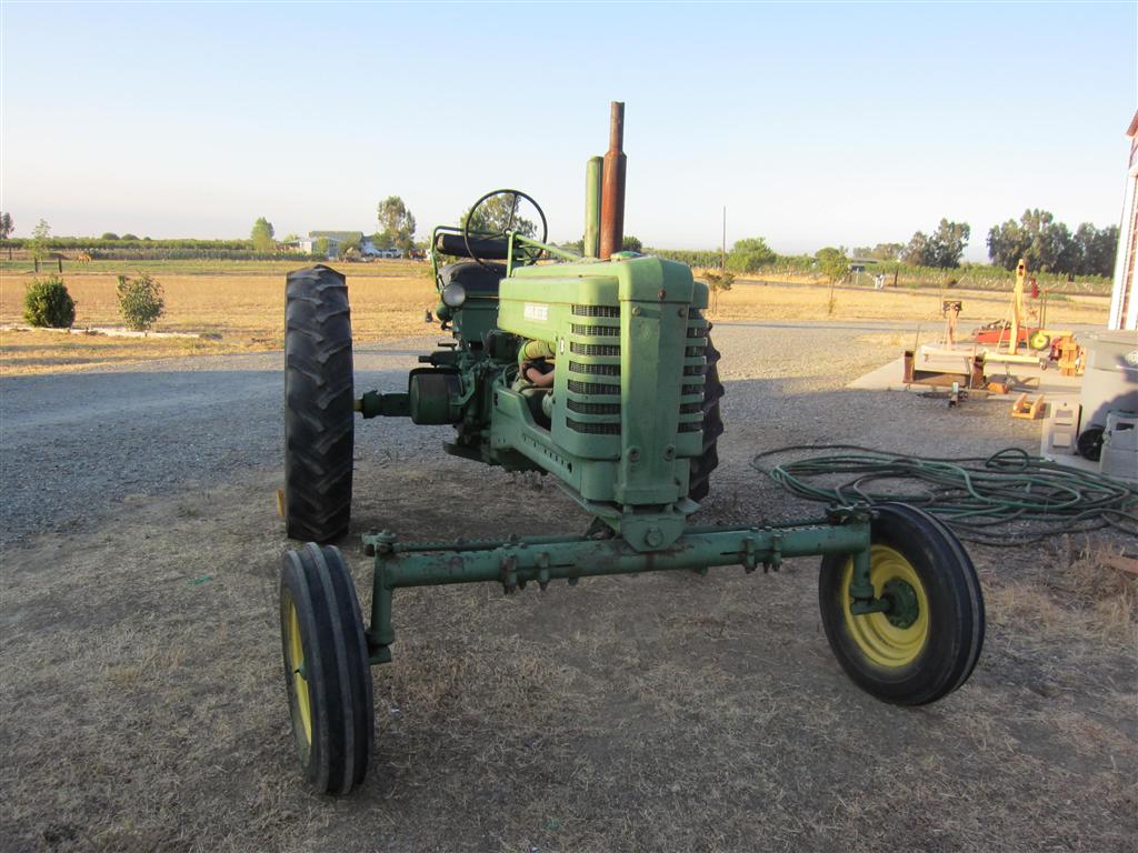

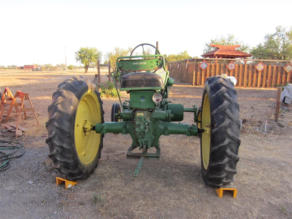

My 1949 JD B had wide front axle with tall spindles and 38" dia rear wheel rims.
A setup like this on the 1710 might work.
Good luck
