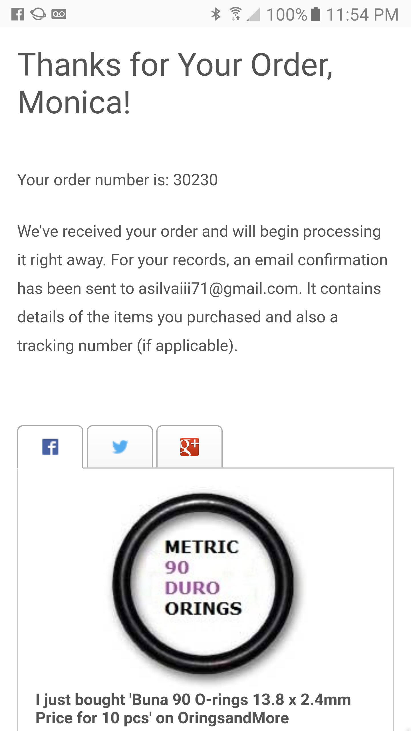

   / Ford 1710 Hydraulic leak #6
These are o rings you need, the others i bought at tractors supply in an assorted pack.

   / Ford 1710 Hydraulic leak #8
This is the orings i used on mine, worked perfect. I do not have an offset.

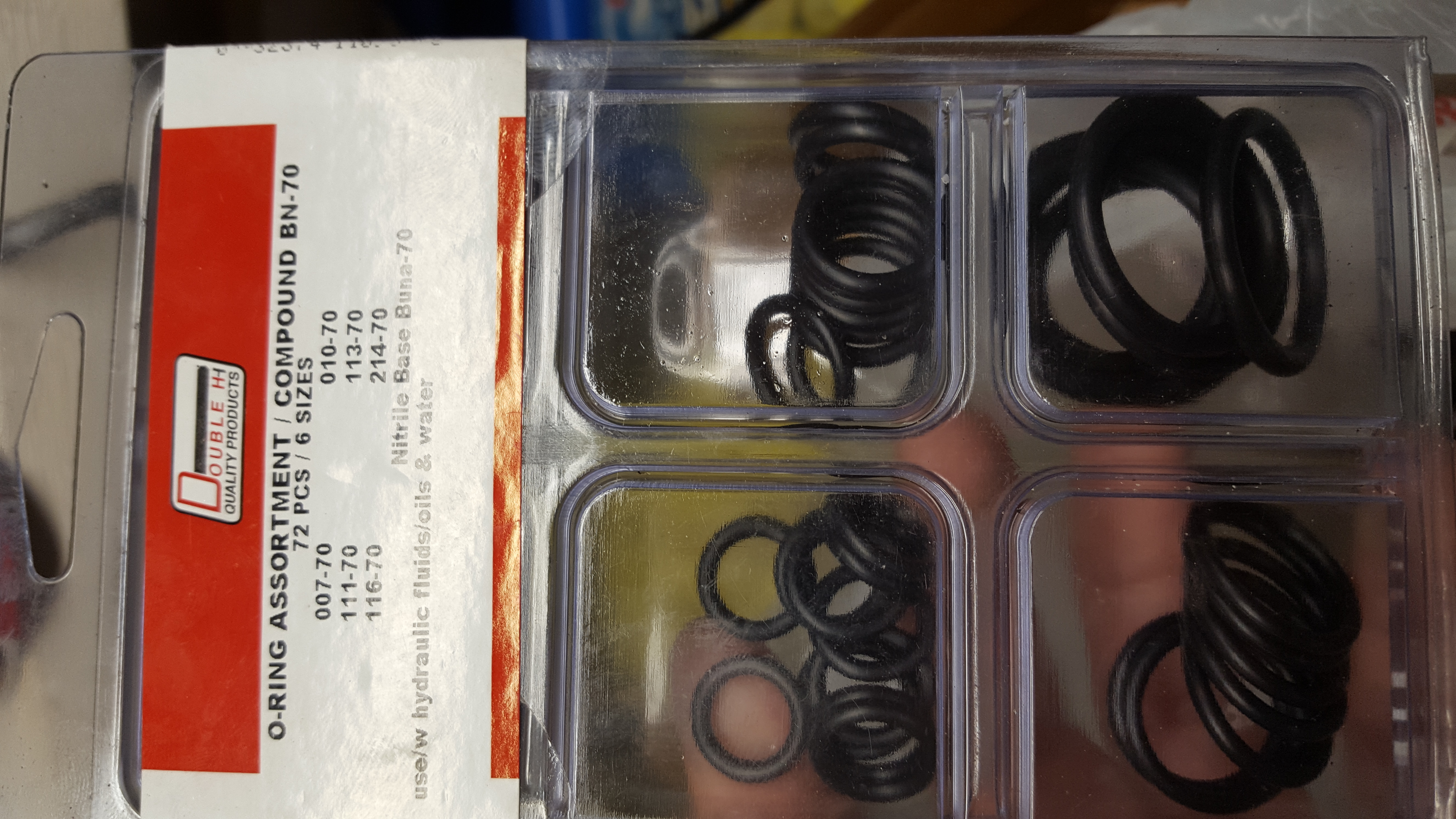

   / Ford 1710 Hydraulic leak #10
Yes I do here it is. The important ones are the first orings I sent. The tractor supply ones go on the banjo bolt at the bottom of the valve. The orings that were leaking on mine and im sure yours also. Is the tube that joins the valve and the pump (#23 on exploded view). When you take orings out look carefully that there are no pieces that fell off. Mine had a piece that fell off and I got it out with long needle nose. Im sure they are not good for the pump.
