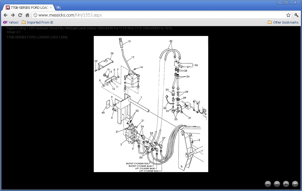

I feel dumb asking this but I'm 40 miles away from the farm.
Can anyone tell me the type of quick connects used on the 770B FEL to the 1710?
Thanks.
   / Ford 1710 Hydraulic Quick Connects #2
Jack, New Holland uses a special type of 3/8" connector for the FEL connections. I've never found a substitute at places like Tractor Supply that carry hydraulic adapters and fittings. Last year I tried another adapter and it did not work. Luckily, all I had was bad o-rings making my QC adapters leak and was able to buy them from my NH dealer for a couple of $ instead of buying new connectors.
EDIT Here are your connector part numbers from Messicks.com
Coupler, Quick, 3/8" Male - 86583622 $20.19
Coupler, Quick, 3/8" Female - 86583553 $29.27
These fittings are shown in the attached diagram, Items 28 and 29.

If you look at the male end and compare it to the ones that are on the Discount Hydraulic Hose website Discount Hydraulic Hose.com you should be able to find a match.
I needed to replace one on my 1715 with the 7108 loader and they had a perfect match, I also bought extras for the future.
Worst case you buy all new male and females that match.
