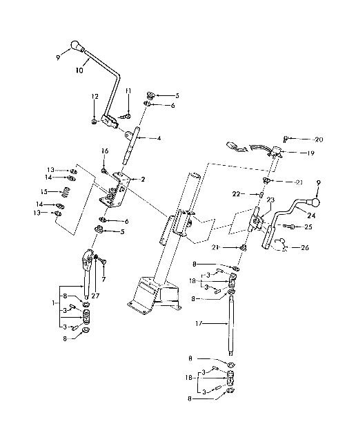

I have a 1989 Ford 1720. It requires the transmission to be in neutral before it will start. While its been getting worse over the past year, now its very hard to get it to start. I believe its the neutral switch. If I play with it enough...moving it around in neutral, it will sometime start just fine. I replaced the solenoid last year so I'm pretty sure the neutral switch is failing. I don't know where to look for this switch or relay. If anyone has any ideas or pointers on how I can find it I would greatly appreciate it.

It sounds like the neutral switch and usually the higher wear part. It could just need an adjustment. In either case, the switch is located on the steering column shift linkage, pn: SBA385202900
ForumRunner_20140309_085028.png Item #11 in the illustration.

Thanks TractorTech, I took apart the panel to get to the part you described. I tightened the bolt for the clamp and now all seems to work fine. Thanks for your advice.
