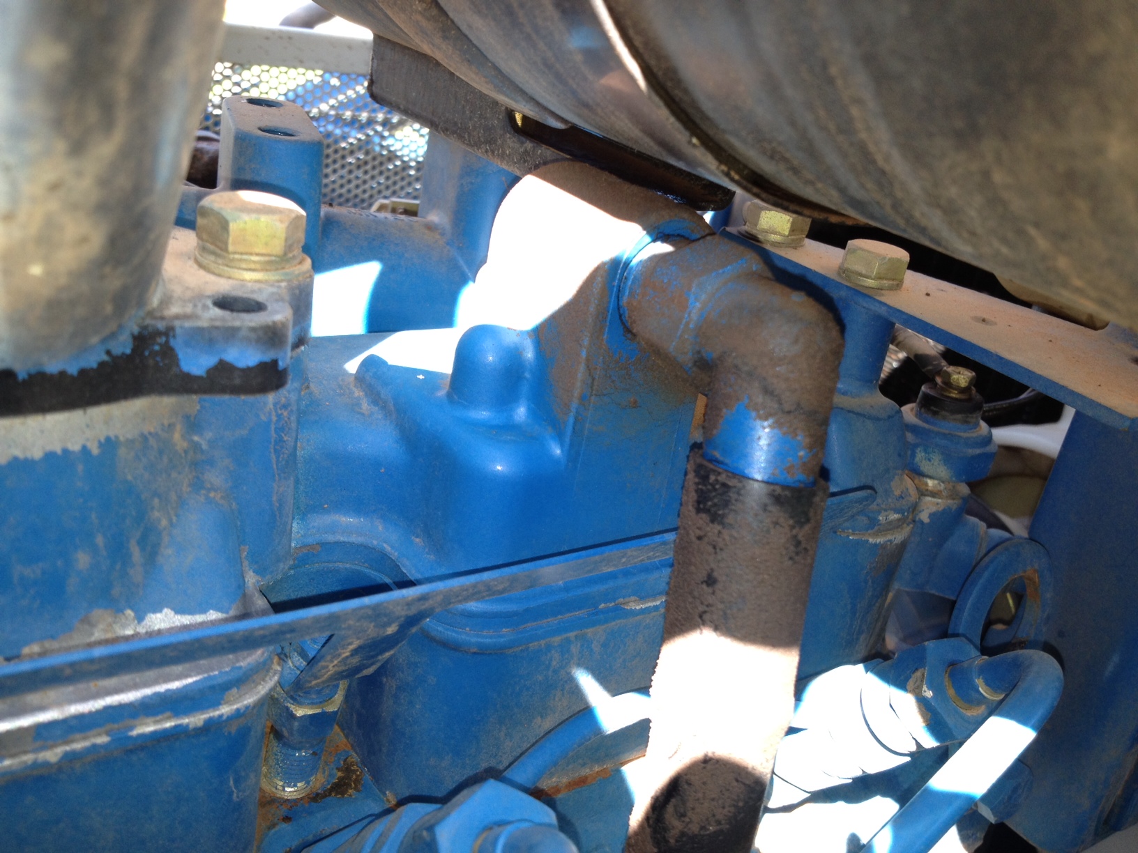

I'm new to the Ford/New Holland 1720 tractor, and I noticed last night there is something wrong somewhere -
Last night, I started and moved the tractor approximately 100 yards. When I turned it off and started to walk away, I noticed an oil puddle under the tractor on the concrete about the diameter of a baseball.
The oil was dripping from an overflow/vent hose from underneath the tractor, and had just about stopped within a minute or two from shutting it off (it appeared that the oil was actively dumping out when the engine was running).
I traced the hose back to the origin - the hose appears to be a vent hose, that originates from the side of the Valve Cover on top of the engine.
A couple of questions:
1. Anybody have any idea what could be causing the oil to dump out the hose?
2. What keeps oil from normally dumping out of the hose in the first place?

Some follow-up info -
-The tractor is new to me, and only has ~ 810 hours. It is a 1991 model. It is in very good shape, and has been kept out of the weather.
- The tractor hasn't been used much in the past 10 years - only 200 hours have been put on it in the last 10 years, and I think it has only had approximately 30 hours of use in the past 3 or 4 years.
-There is no visible smoke from the exhaust when the tractor is started or while the tractor is running. The engine runs strong.
- The oil from the vent hose only occurs after the tractor warms up. After the tractor warms up, there is a visible vapor (oil or exhaust vapor?) exiting from the vent hose, along with a good amount of oil. The amount of oil exiting the hose will fill a teaspoon in ~ 10-20 seconds.
- Attached is a photo of where the vent attaches to the valve cover.
1. Is there anything else besides piston blow-by that could be causing this problem (high pressure in the valve cover/crankcase, with oil spewing from the vent hose)?
2. Is it possible the blow-by is normal, and the oil blowing out is due to a faulty trap/valve to keep the oil from blowing out?
3. Is it possible this problem is a symptom of it not being used for several years? Is it possible this problem will clear itself up with more hours on the tractor?
4. Is there any harm to the tractor by running it in this condition, besides having to check the oil more often?
Thanks for everybody's help!
p.s. - does anybody know where I can find an exploded parts diagram?
-Mark

It is not normal.
I would change the oil & refill with 15w40 or Shell Rotella T6 5w40 synthetic and install a new filter.
Check coolant level.
Does the engine coolant temperature guage show it is warming up?
Look in the oil fill spout to see if there is any moisture, (white foam)
When running you can check for moisture by placing a mirror near the engine breather, moisture will condense on the glass oil vapor will not.
Does the engine start easy & run smoothly at idle?
It is remotely possible that the cylinders are glazzed due to low HP & cold operation.
The early model tractors had a defective thermostat housing which prevented the engine form warming up. There was a recall on this.
I have heard of this condition sometimes being resolved by running hard or on a PTO dyno which loads the rings forcing them to seal.
The 1720 is a very good tractor. I have 2200 hours on mine and it earned every one of them.

I did change the oil this past weekend - the last documented oil change was around 200 hours ago (nearly 10 years ago), and I presume this was indeed the last oil change. The oil that came out was not foamy or had any indications of contamination with water. I put 10W-40 dino back in it.
I'll check for moisture using the mirror trick by the vent. I did notice that if I remove the oil fill cover, the oil no longer drips from the vent hose - this is why I believe that the oil is being forced out of the tube simply by the amount of pressure in the crankcase...just not sure if piston blow-by could be the only cause of this.
The temperature gauge does deflect as it warms up. I didn't check the coolant though - will do that this evening.
As I said, the tractor runs great & has no visible smoke from the exhaust.
One other thing that just popped in my head - is it possible for too much exhaust back pressure to cause this problem? The exhaust on this tractor comes straight up via a baffle, without anything covering the exhaust on the end of the pipe. I wonder if something has gotten down in there and maybe has increased the exhaust back pressure?

Exhaust back pressure won't cause this.
In reading the history of this tractor in your post, I believe you have excessive blowby as a result of stuck rings from the tractor not being used very much. I'd be surprised if it also wasn't "wet stacking" ( black, oily exhaust residue in the exhaust pipe) as a result of not being used at even moderate powers very often.
I'd work the snot out of it for several hours (plowing is a good excercise) making sure the engine comes up to operating temperature while you are doing so. Watch the oil level and don't let it get too below the min allowable level when you are doing this. A few hours of hard work should cure this problem.
