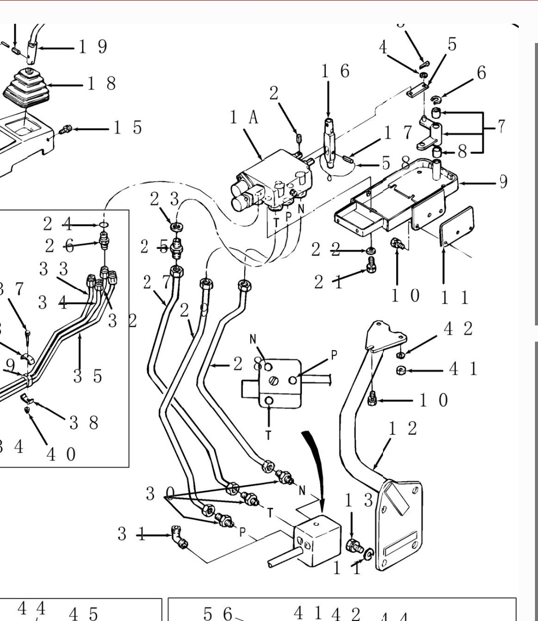

I have a 1998 ford new holland 1720. 1000hrs. Has a 7308 loader attached. Just bought it. The loader is slow moving at any rpm unless I dead head the 3pt all the way up then it flies. I read in another forum the guys lines from the diverter valve to the control valve for the loaded were crossed. I’m not quite sure how I can figure that out. I don’t see any markings on either item to identify that. Looks like a factory or dealer install loader. Replaced the 3 o rings on the spool inside the pressure relief/ diverter valve. No change. Changed the hydraulic filter. No change. Plugged and unplugged the quick connects a few times. No change. Im not sure what else to check

Welcome to TBN.
Is your valve a Ford valve or aftermarket?
Here is the Ford diagram

Thank you. Yes that’s exactly what I have. Appears to be plumbed correctly
