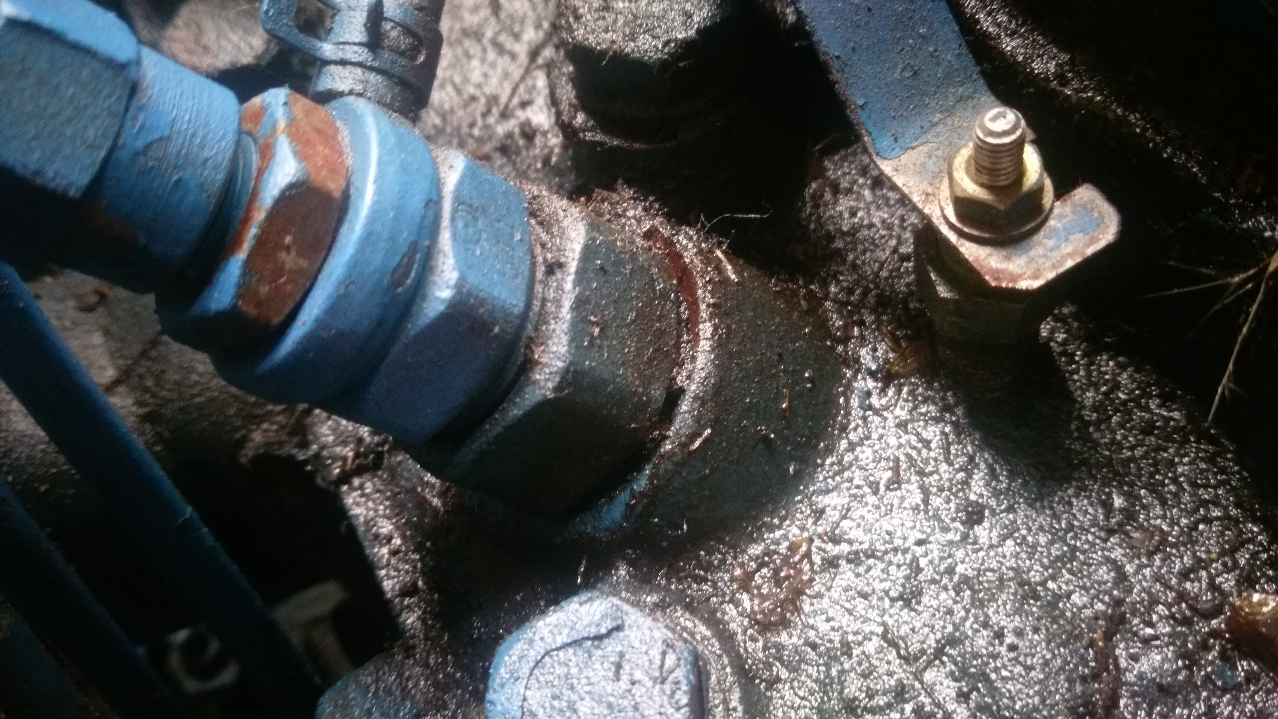

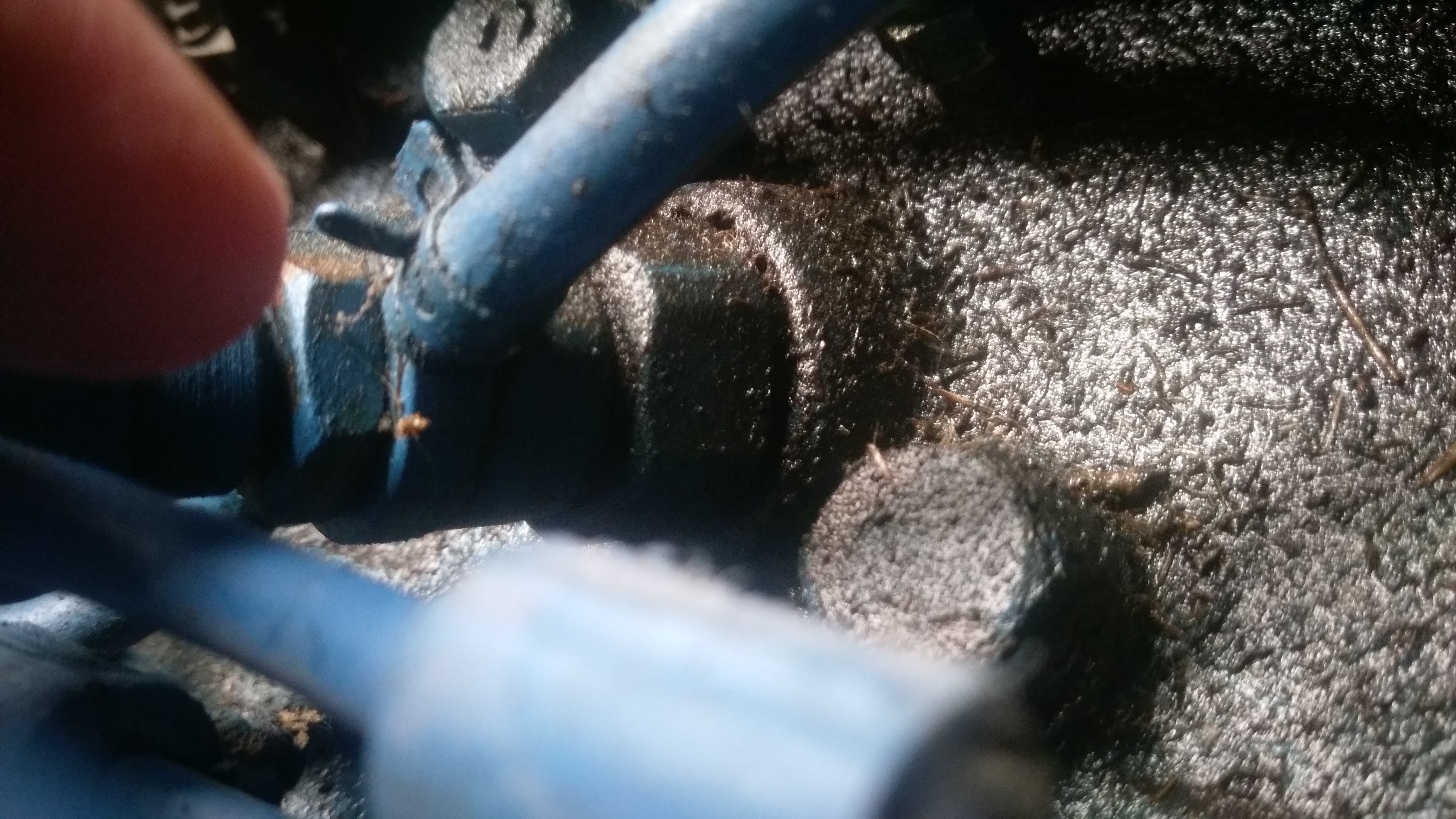

I have a 1910 that I've discovered has a leak where the injectors are screwed into the head. Crazy how it was discovered. I was refueling and spilled a bit of diesel fuel over the engine. What I eventually saw, was right where the injectors are going into the head, there were air bubbles forming. Not a lot, but definitely happening, kinda like how you would use soapy water to find a hole in tire. Is it as simple as tightening the injector down?

Yes & no.. there is a copper gasket under it.. you could TRY to tighten it OR remove the injector [pita] flip the gasket or get a new one & ask the dealer what the PROPER tightening torque is..
HINT> tighten from the BIG body nut, NOT the small hex..
That means you have to take off the return lines from all the injectors, so you may as well take the injector out & flip/get a new gasket.
AND check the others for tightness.. you don't want to do it again for a long time..

Thanks, makes sense. I will be replacing the copper gaskets. While I have it off, are there any other recommended parts that you would replace while I'm at it?
Also, if anyone has the torque specs for these, that would be greatly appreciated. I'll continue to dig deeper. I might have a manual with the specs, but I'll have to look at it a bit more closely. Again, just trying to get it all done while I have it off/broke down.

I torque them to 50-55 ftlbs from the big hex. no problems & no leaks.
