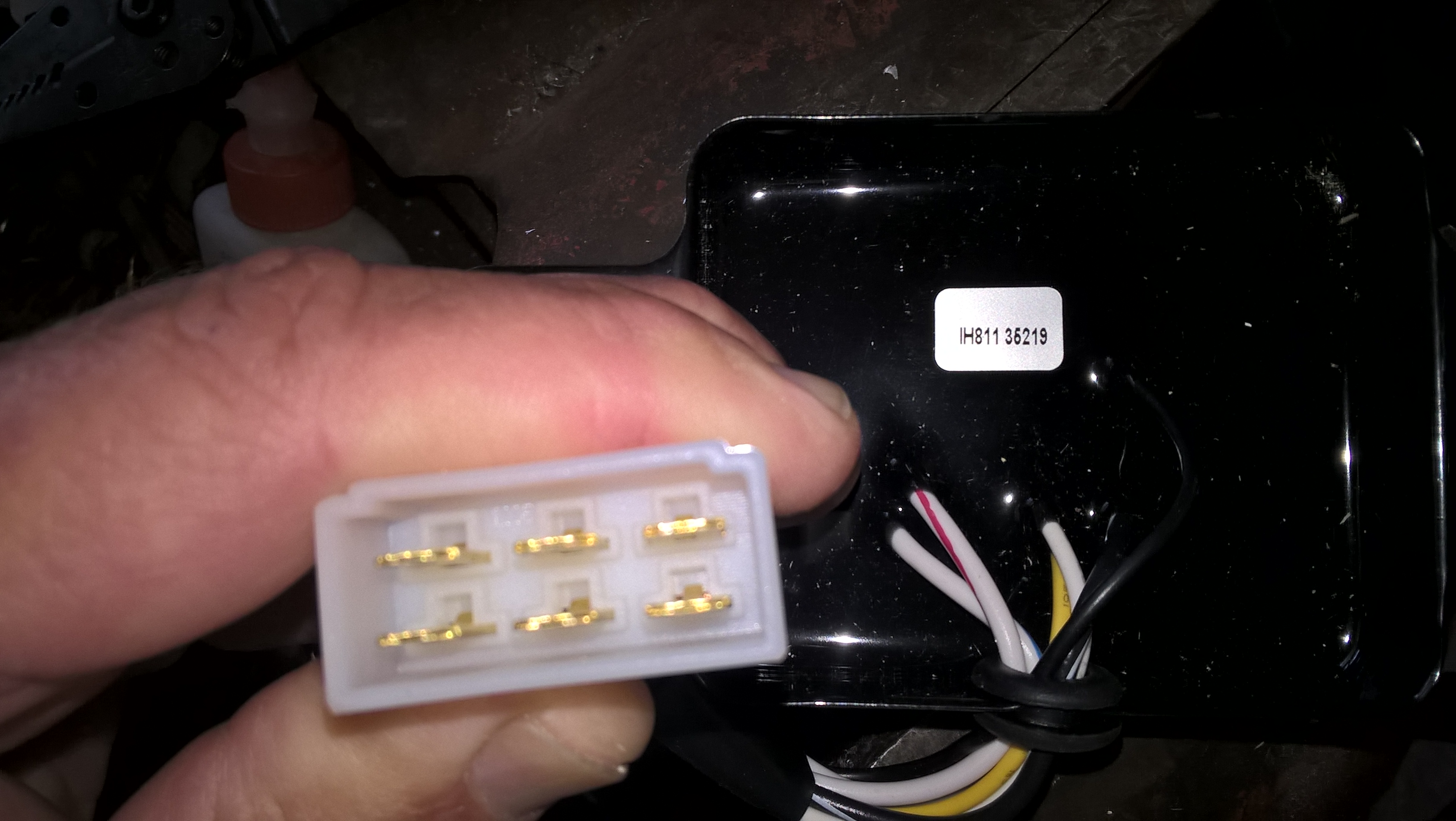

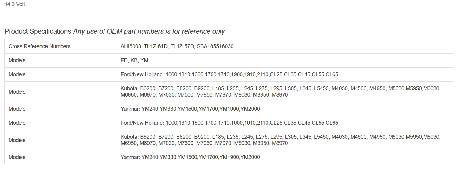

Thanks Dave for your reply - unfortunately I dont have much. I got the box and the regulator. The plug, according to the importer is the same as OEM, see attached photos. I have also attached photos of the plug with the backside of the VR and the box label as well as the cross reference applicability. I hope these can help you out.

my plug has 6 tabs so maybe that is common to bigger systems, thanks for your reply.
